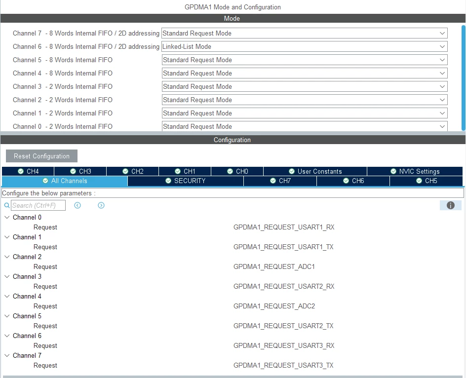

I need a clarification about the configuration of GPDMA1 in linked list mode.

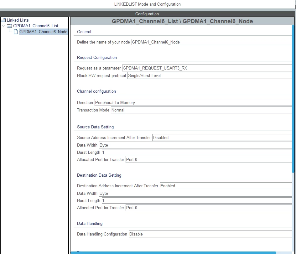

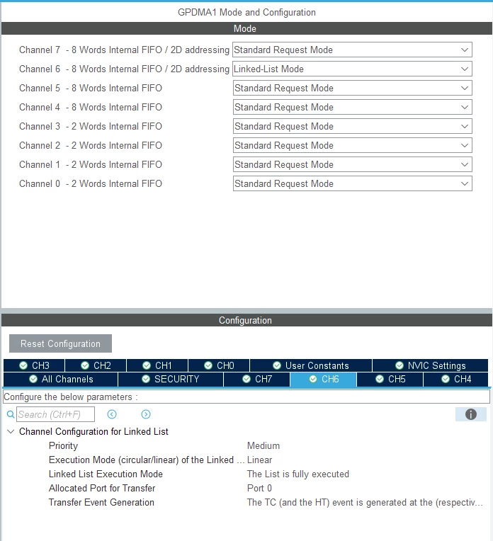

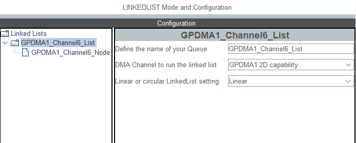

I configure it using Cube MX v6.13.0, here some screenshots I took about the settings done:

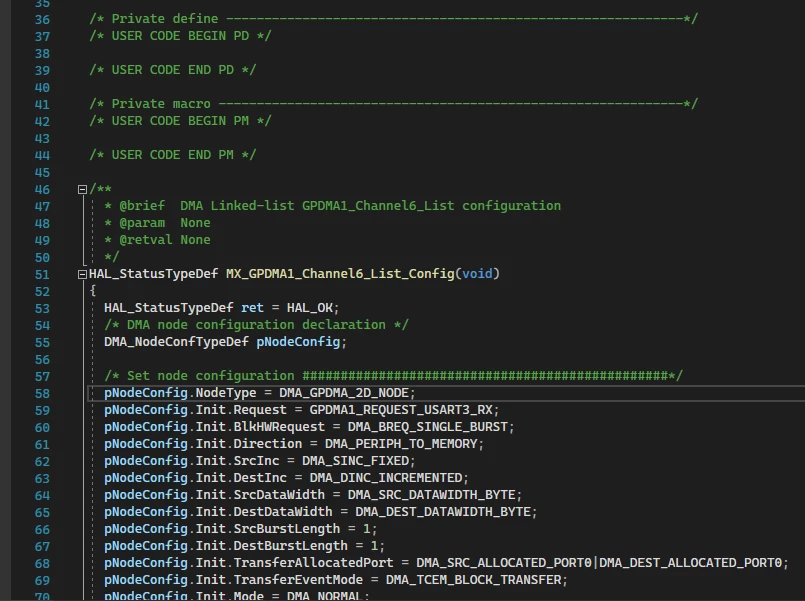

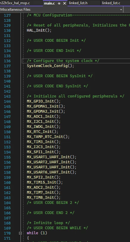

When I generate the code, in linked_list.c file I found the function MX_GPDMA1_Channel6_List_Config that is not called by anyone....is it this correct or I missed some settings?
