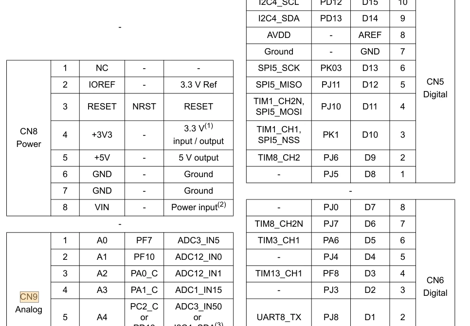

Correct, on the DISCO side they should be on the same plane.
On Arduino shields I'd be more circumspect, and check the continuity, especially proto-shields as they might not have copper/routing between pins of the same designation on either side of the board / connectors.
