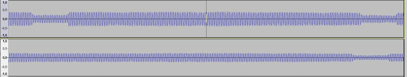

Dear all,

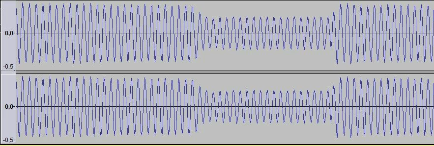

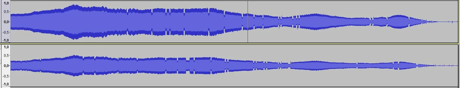

I have a issue with SPDIF_TX on a nucleo F746ZG. Working on this since some days and can't identify the problem. I have some hearable ''glitches'' in an otherway working operation. A frequency sweep signal allows to reproduce those glitches on a regular basis. I recorded the output of the DAC/Amp and you can see in the attachment the visualization of the glitches: 4 ms amplitude ''dents'' in the signal. The 3 files attached allow to precisely visualize the issue. Please have a look. What is odd is that there is still the expected signal oscillation, but the amplitude is reduced for about 4ms or what looks like of multiple of 4 ms.
The upper part of the dataflow that prepares the data for the SAI has been well tested on a stm32F4 Discovery with I2S and onboard DAC without showing such a behaviour.
I prepare a buffer that is read by DMA (circular mode) to feed the SAI configured for SPDIF protocol. As SPDIF data are fixed in Stm32 to 24 bits for SPDIF, I prepare a buffer of int32 that I fill with int16 shifted by 8 bits (<<8). I alternate Left and Right music samples.
I noticed that I don't have the same result in the 3 below cases:
- 0 for Left channel and music for Right: music and glitches in Right channel, silence on left channel
- music (same data) in Left and Right channels: glitches in Left and right channels,
- strange: - Music for Left channel and 0 for Right: music and NO glitches in Left channel, silence on right channel !!!!
So feeding the SAI with comparable data does not give the same result:  0=>L/Music=>R different from  0=>R/Music=>L

You can also see in the big zoom that the signal is perfectly continuous. In case of buffer underrun/overrun, you expect some discontinuity in the signal...
Looking at the specs of the SPDIF interface, I wonder if it could be related to some protection scheme of the consumer type SPDIF interface.
I currently don' t manage the Channel Status bits. Could it trigger some faults in my SPDIF receiver like the ones in the above attachments?

Solved !!!!
You can have a look at
http://www.eevblog.com/forum/microcontrollers/stm32-sai-spdif_tx-issue/
or
http://www.diyaudio.com/forums/digital-line-level/293603-can-low-jitter-achieved-stm32-microcontroller-25.html#post4894411
I was writing by error randomly in the SPDIF Channel Status bits and tickling the ''pre-emphasis'' bit, having the de-emphasis filter switching on and off.
