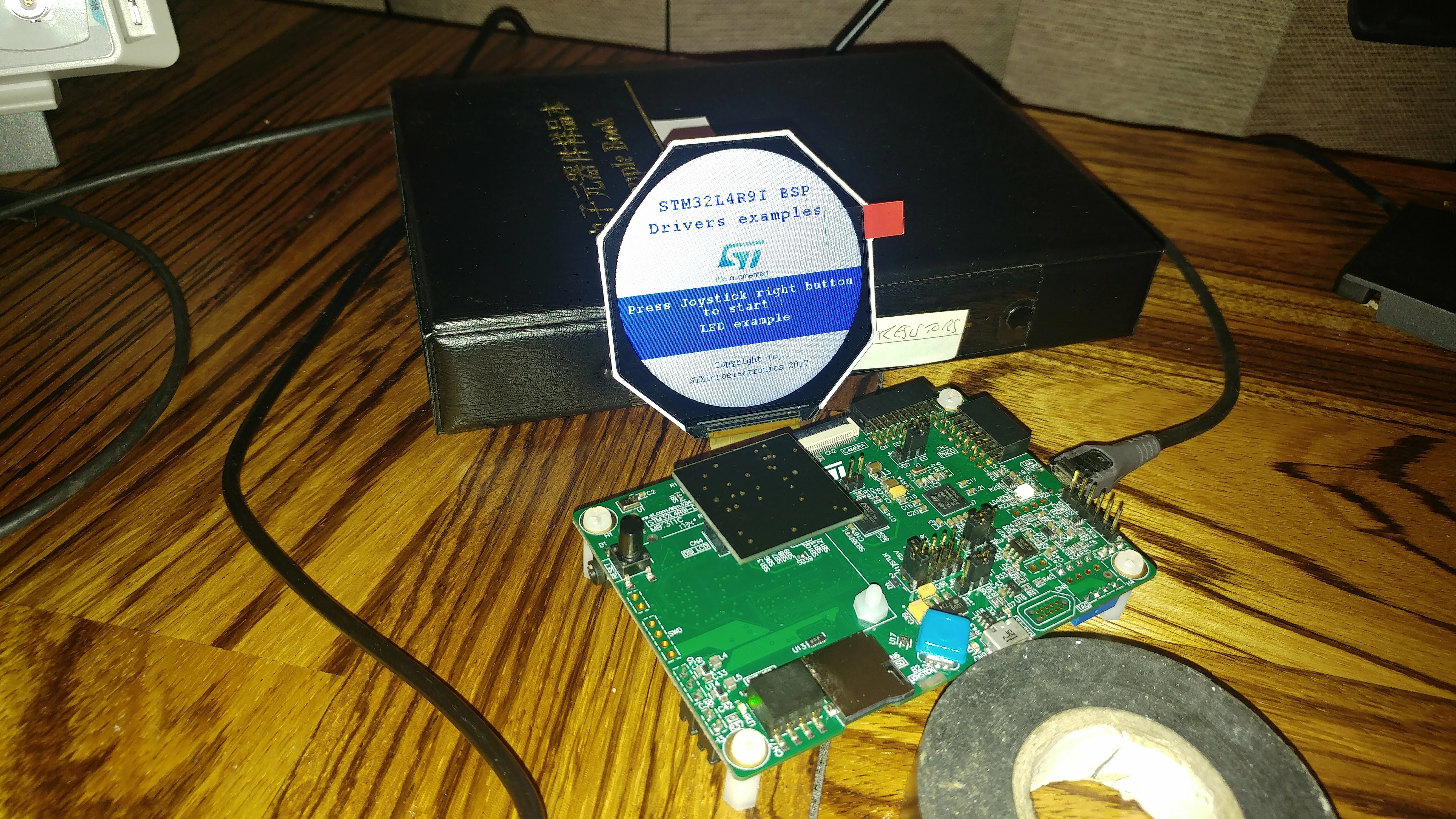

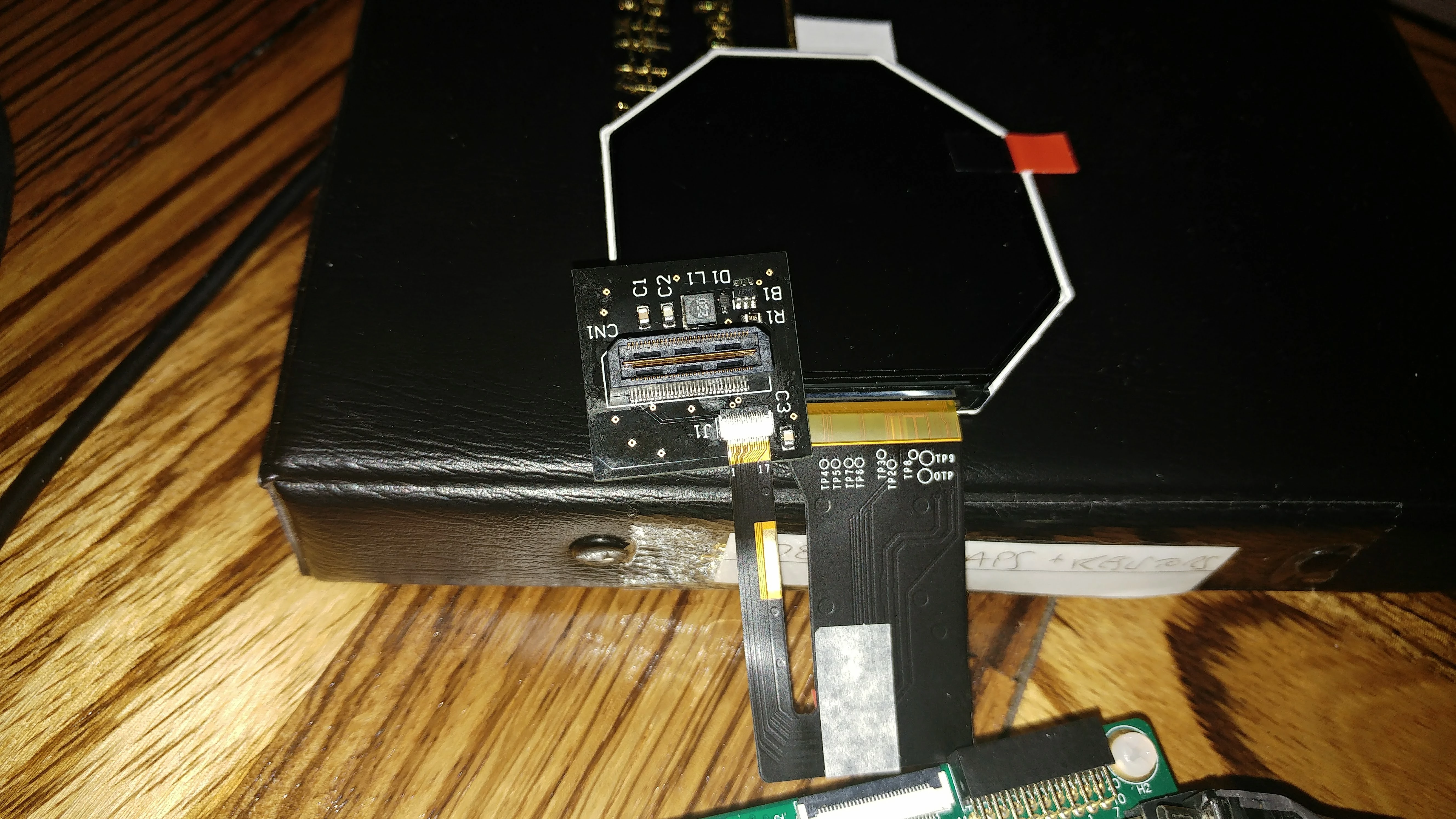

Hi.
I am doing well. The Panasys 3.4' round TFT (actually it's about 2.4' round, in an octagon, that was probably cut from a 3.4' square once upon a time) MIPI DSI display is working on the stm32l4r9i-discovery, after I made a little adapter board with backlight driver. (
https://www.eevblog.com/forum/projects/critique-my-first-pcb/msg1672430/#msg1672430
but.. the circle is offset, and I'm sure it's because the GFXMMU LUT is for the 390*390 amoled.
I looked at CubeMX, and also I read the AN5051 application note. This says that the panel manufacturer will say what is the first and last pixel of each row.
But they don't
Can't this be worked out? Something to do with Pi and what not?
Do I really have to enter each start and end pixel  for my 320*320 round TFT?
    Yes, I'd imagine it would be covered by secondary school math.
    On cheaper hardware I'd presume they just store and send a 320x320 bitmap/raster. The ma gic of the GFXMMU you can optimize the frame buffer so you're not wasting memory that the display clips/masks.
    Only in the same sense as you would 'enter' a sine table, I'd either compute it on the fly, on have a PC side app compute and spit out a block of C code to the console.
    Here you need to create a cropping table. You could probably create a octogon if that were easier.
    320 / 8 = 80 so from lines 0 thru 79, starting point being 80, 79, 78, 77, ... decrementing for each line. The end points 239, 240, 241, ... the middle 160 lines as 0 thru 319, and then the last 80 reversing the sequence of the first 80.
    For a circle zero thru 319, use sine over PI radians

    It works :)
    It's been quite a successful weekend. I roughly understand how to use TrueStudio and CubeMX, and how to compile the example code.
    My first attempt at a PCB design has worked out (Discovery DSI adapter board for Panasys LCD, with back-light driver), as well as my first attempt at reflow soldering with a toaster reflow oven.
    And then, getting the actual MIPI DSI screen working with the example code has worked out successfully too!
    I do have a question though, if anybody knows about round TFTs. In the example code, they give pixel xPos (column) = 0 for centered text. This didn't work for my panel. I had to give BSP_LCD_GetXSize() / 2 (i.e. 160.. the middle).
    Do some round displays treat 0 as the centre? Or have I missed something else somewhere? I have basically looked for everything to do with 390*390 and changed it to 320*320..
