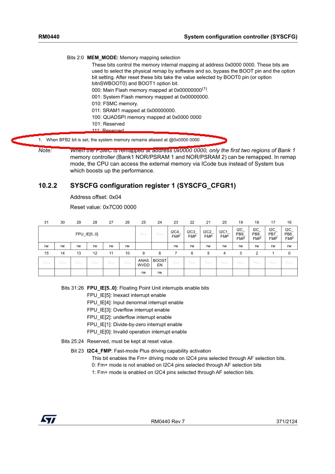

waclawek.jan
February 26, 2023
> FLASH_OPTR register has a value of 0xfbff'f800
That means, BFB2=1:
and if VTOR = 0, your interrupts end up at addresses given by system memory's vector table.

Old thread, but as there is no solution, maybe someone needs this>
BOOT0 must be grounded and not floating, fixed it for me
