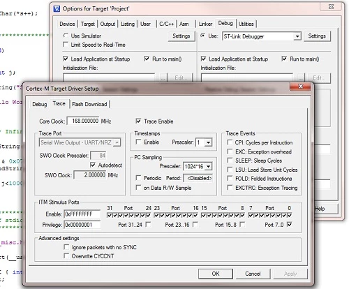

 I know the settings for the core clock speed are important so i set it correctly to 168MHz . Here is the snapshot to be sure. http://imgur.com/jSiUY2a,bqdc5c9&sharp1
What am i missing here ? Seems my debug view gets nothing . Any help for me ?

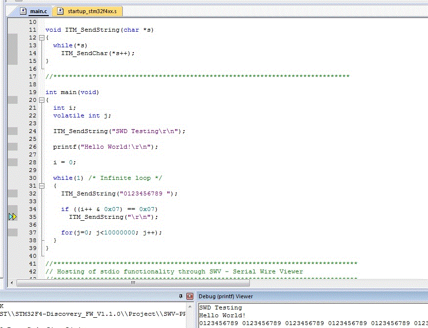

    I'd probably check the 'Port 0..7' option, and use the ITM_SendChar() function.Posted some non RTX examples of using the SWV and Keil to the forum.
    https://community.st.com/0D50X00009XkgG8SAJ
     Might want to update the ST-LINK firmware, looks rather dated.
    Edit: Fixed DEAD LINK, original post from 11-Jun-2015

    // STM32F4-DISCO SWV DEMO - sourcer32@gmail.com
    // Make sure SB12 is make, and trace speed matches core frequency as built
    #include <
    stdio.h
    #include ''stm32f4_discovery.h''
    void ITM_SendString(char *s)
    while(*s)
    ITM_SendChar(*s++);
    int main(void)
    int i;
    volatile int j;
    ITM_SendString(''SWD Testing
    printf(''Hello World!
    i = 0;
    while(1) /* Infinite loop */
    ITM_SendString(''0123456789 '');
    if ((i++ & 0x07) == 0x07)
    ITM_SendString(''
    for(j=0; j<
    10000000
    ; j++);
    // Hosting of stdio functionality through SWV - Serial Wire Viewer
    #include <rt_misc.h>
    #pragma import(__use_no_semihosting_swi)
    struct __FILE { int handle; /* Add whatever you need here */ };
    FILE __stdout;
    FILE __stdin;
    int fputc(int ch, FILE *f)
    ITM_SendChar(ch);
    return(ch);
    int fgetc(FILE *f)
    char ch;
    ch = '?';
    return((int)ch);
    int ferror(FILE *f)
    /* Your implementation of ferror */
    return EOF;
    void _ttywrch(int ch)
    ITM_SendChar(ch);
    void _sys_exit(int return_code)
    label: goto label; /* endless loop */
    #ifdef USE_FULL_ASSERT
    * @brief Reports the name of the source file and the source line number
    * where the assert_param error has occurred.
    * @param file: pointer to the source file name
    * @param line: assert_param error line source number
    * @retval None
    void assert_failed(uint8_t* file, uint32_t line)
    ex: printf(''Wrong parameters value: file %s on line %d
    '', file, line) */
    /* Infinite loop */
    while (1)
    #endif
