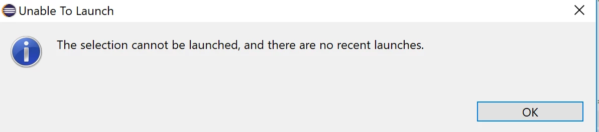

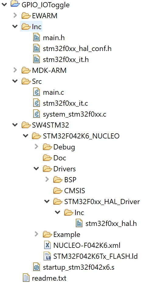

Hi guys , I downloaded the examples and I am simply trying to compile the toggle led example
en.stm32cubef0\STM32Cube_FW_F0_V1.9.0\Projects\STM32F042K6-Nucleo\Examples\GPIO\GPIO_IOToggle\Src
I opened the project and this is the structure:
If I try to Download on the board with the Run and Debug options I receive the message that it is unable to Launch.
 Any suggestions?

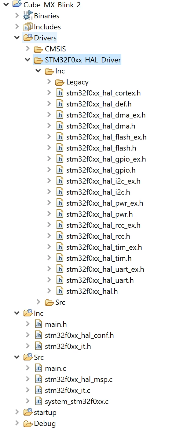

    I think you can't see the images I copied in the first message so I upload here:

    Can't speak to SW4STM32/Eclipse, not my deal.
    Projects should build as is.
    Project needs to build completely before you can download and run.
    When you copy in LED3_GPIO_CLK_ENABLE(); you should perhaps look at where you're copying it from, and where the macro is actually defined, like in an include file you're not using/providing.

    Hello, of course the project is built before downloaded. However, I don't see why it says there are no recent launches and cannot proceed. I am building an embedded project provided by the STM itself. I think they need to make a straightforward guide for a beginner.
    Your original post inferred you just launched, and subsequent builds failed with errors.
