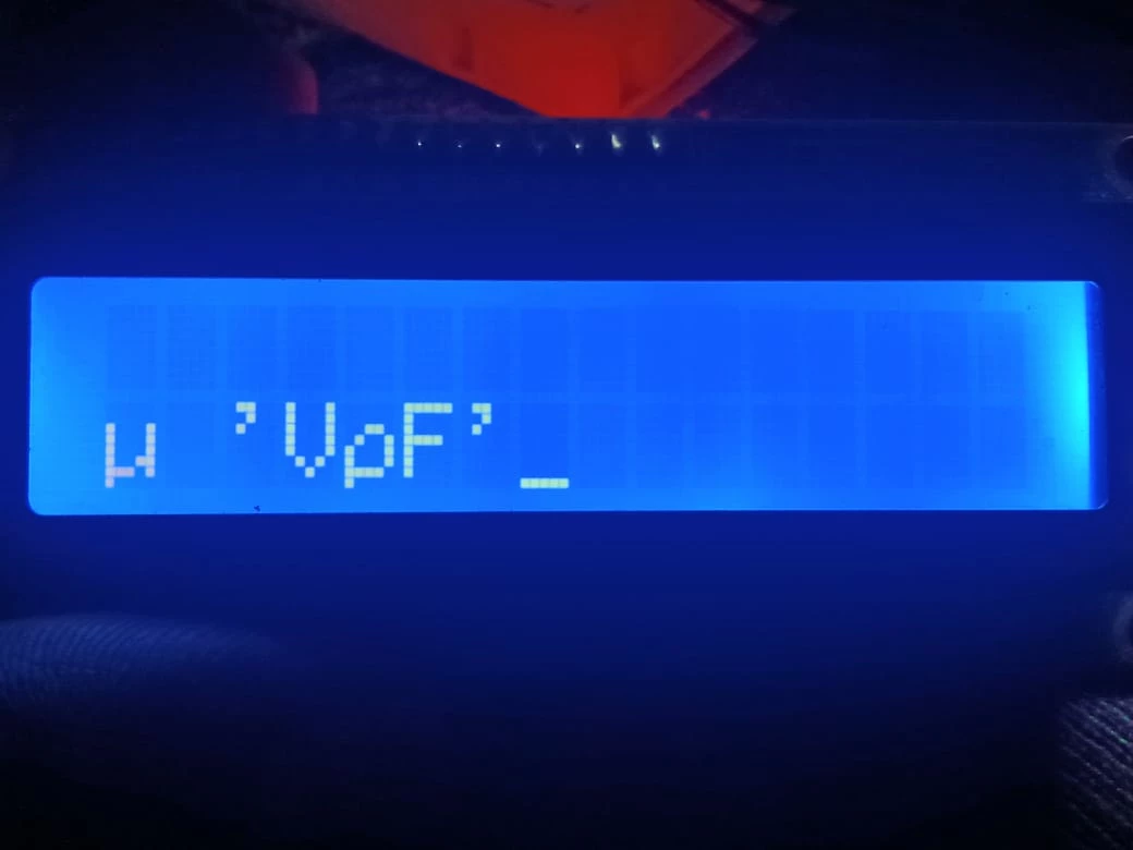

Getting Junk data on I2C LCD 16x2 display while interfacing with stm32f401re Micro controller . please help
0693W00000AN7W0QAL.jpgInterfaced i2c_lcd with stm32f401re and try to program without any library .but getting junk data always,tried changing delay but same.

Hello NChun.1,
you did not write what display are you using. So I am not sure what protocol of communication is expected. But are you sure you could just write the all the commands and data in one block between 1 start and 1 stop? Further I would recommend you to check the transmission with either another slave device or oscilloscope to see whether you are really sending what expected. It will also help to determine if there is problem with the display or with your code.

Thank you for ur inputs.Now Lcd display is working fine after changing sequence of the data.
