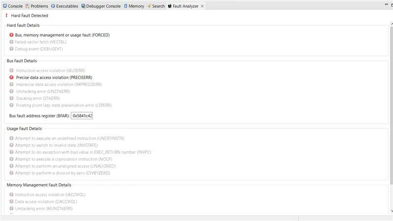

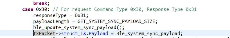

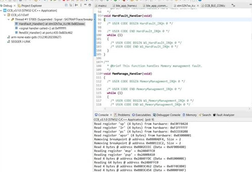

Hello all I am facing a issue my program works however when is executes this part it runs only once after that it ran into hard fault. I have attached the snap of structure part of code which cause it and also exception observation please let me know if you do have any suggestion.

Identify the processor
Show the registers
Show the code (disassembly) at the failure
Reading something from a bad pointer? Misaligned?
