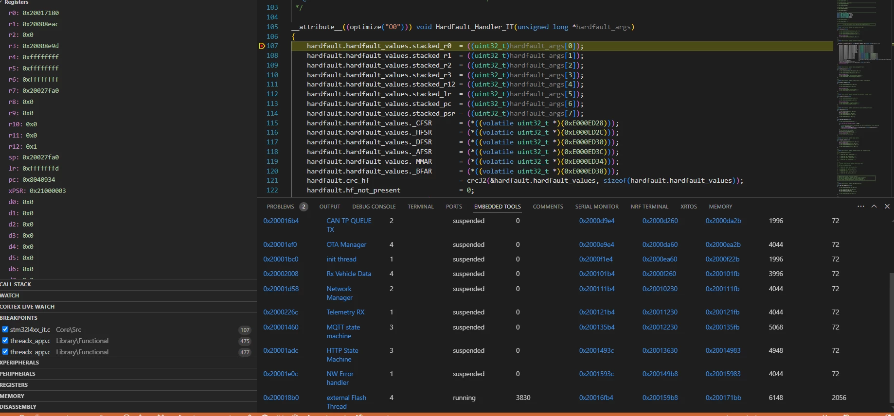

Getting Hardfault when creating a local variable and not getting Hardfault when making the same variable Global

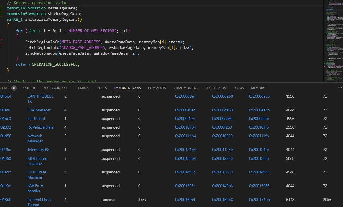

Im using threadx, in that i have defined a task in which i initialize my external flash memory regions
i have a 116 byte structure which contains memory information
when i use this structure locally i get a never execute hardfault error where as when i move that variable to global i dont get hardfault
please note that the stack size of task is 6200 bytes
Attaching screenshots

Andrew Neil
July 3, 2024
So have you tried increasing that - by at least 116 bytes ... ?
Hjain.1
Hjain.1Author
July 3, 2024
as you can see my stack is barely full only 2kb is used and yes i did try increasing it
Tesla DeLorean
Guru
July 3, 2024
What specifically is the nature of the Hard Fault, see registers, stack and instructions.
If not a stack overflow, perhaps corruption or modifying out of bounds.
Failure at return?
Use for a DMA or IT routine and losing scope?
