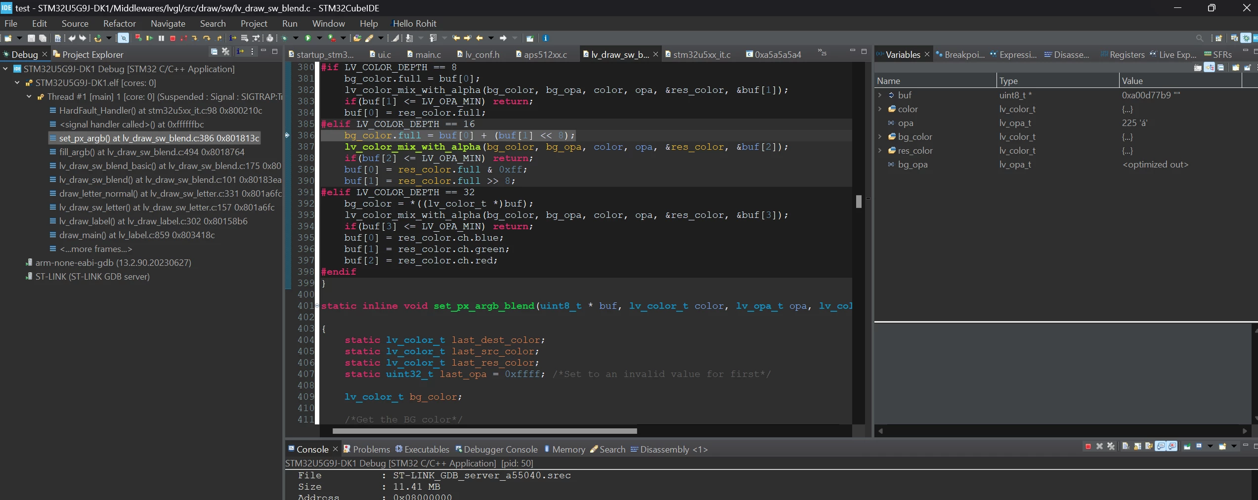

Getting error after integrating lvgl in stm32u5 dk1 board
I am new to firmware and integrated LVGL in stm32u5 dk1 board . And my elf hex file size is bigger than internal flash hence using external flash for lvgl images . Also running LVGL in external psram . After running I see first screen then it goes immediately to hardfault . Not able to understand this hardfault reason . Need help here . And I checked that PSRAM and External flash is working fine . I have copied entire code at github https://github.com/rohit-trustedwear/stm32dk1-code . the fault is happening at line bg_color.full = buf[0] + (buf[1] << 8); in

screenshot attached here

Hello @Rohit-Trustedwear ,
I recommend you to take a look at this FAQ: How to debug a HardFault on an Arm Cortex®-M STM32.
In this article, we explain how to debug faults on Arm Cortex®-M based STM32 devices. In the process, we learn about fault registers, how to automate fault analysis, and figure out ways to recover from some faults.
I hope this help you.
