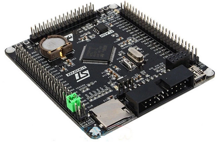

Getting Error 2 on building project
0693W000007DKiWQAW.jpgHi,
I created a new project using the GUI and after pressing the Build button, I always get below information on the Console window.
The development board I'm using is STM32F407VET6 Black Board.
20:47:42 **** Incremental Build of configuration Debug for project ProjectOne ****
make -j2 all
arm-none-eabi-gcc -o "ProjectOne.elf" @"objects.list"  -mcpu=cortex-m4 -T"E:\antiQue`s Stuff\Projects\STMicro Cube\ProjectOne\STM32F407VETX_FLASH.ld" --specs=nosys.specs -Wl,-Map="ProjectOne.map" -Wl,--gc-sections -static --specs=nano.specs -mfpu=fpv4-sp-d16 -mfloat-abi=hard -mthumb -Wl,--start-group -lc -lm -Wl,--end-group
c:/st/stm32cubeide_1.5.0/stm32cubeide/plugins/com.st.stm32cube.ide.mcu.externaltools.make.win32_1.5.0.202011040924/tools/bin/sh: syntax error: EOF in backquote substitution
make: *** [makefile:59: ProjectOne.elf] Error 2
"make -j2 all" terminated with exit code 2. Build might be incomplete.
20:47:43 Build Failed. 1 errors, 0 warnings. (took 796ms)
Please help me with this. It has been happening since I installed the IDE to get started. Not able to even try LED blinking.
Emin Yagmahan
Emin YagmahanBest answer
Jan 31, 2021 4:20 PM UTC
Possibly, the error could be caused by your project path. Your path contains special characters (`).
Renaming the folder might be helpful.

MVerm.2
MVerm.2Author
Jan 31, 2021 4:41 PM UTC
This resolved the issue.
Thank you So much @Community member​
