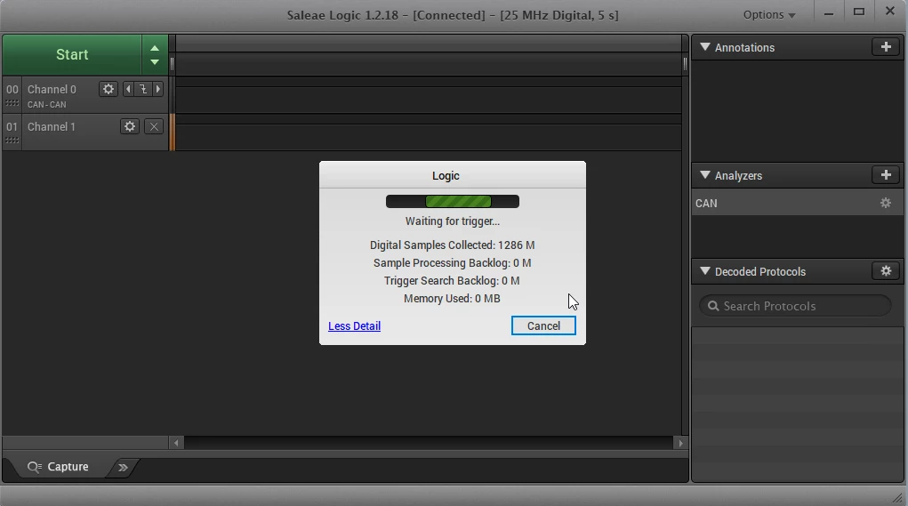

get no coomunication via FDCAN1 on STM32G431RB NUCLEO board
0693W000001pQcvQAE.pngHi,
I try to send data via CAN from the nucleo board to a USB-to-CAN device (peakCAN).
I configured PA12 and PA11 as FDCAN1_TX and FDCAN1_RX. I measured pin 12 and pin 14 on the CN10 connector with a salea logic device, but got no valid frame. Pin 12 stays high (3.3V) and pin 14 remains low (0V).
I also tried to change the PLL-frequency for the CAN peripheral to 40MHz as mentioned in some other posts (seen in the snippets below) - but it has the same effect like my implementation with 36MHz...
Can anyone help me with this problem? Thanks a lot...

SKacp.1
SKacp.1Best answer
May 26, 2020 7:47 PM UTC
Please se my code for Nucleo-64 STM32G474RE. Its works.
Baudrate for CAN I set on 1000 kbit/s.
Clock for FDCAN is set on 80 MHz.
Please check settings for the instance "hfdcan1" and the system clock configuration.
I check this example with UCANDevices https://ucandevices.github.io/uccb.html
Best regards,
Slawek
1 reply
