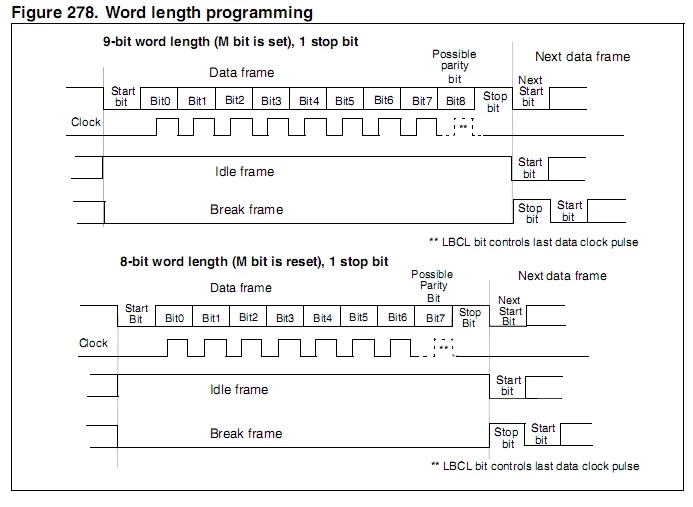

I have already had a project about stm32f103c8t6 chip.I used rs485 to transfer data beetwen 2 board via SN751768P IC.I'm sure that all things about schematic are fine.I transfer data without break signal is ok. ex: I send 0xff from sending board (master) and I receive 0xff from getting board (slave).
BUT when I send break frame (USART2->CR1 |= 0x0001;).data of me have change: I send 0xff from master but receive 0x00,0x03 or 0x01, from slave.
I have already read about break frame in USART character description item of STM32F103xB usermanual. I think that stop bit at the end of each of break frame is reason make data error.(I have attached my picture)

    I'm not sure I have any specific knowledge here, but take a look at what's going on with the signal with a scope.
    From the documentation it's not clear that the usage of USART_SendBreak() is dependent on the state of TC or TXE, or if one should wait before and/or after for those to assert. The latter might be important if you're disabling a transceiver or something.

    Thanks for reply.I'm sure that transmit packet is ok.
    I have already designed 2 receivers: use 2 difference chips : stm8s and stm32. Also 1 transmitter, I used stm32 chip.
    + with stm8 slave: I use USART interrupt to get 512 bytes of data and detect break signal (to know start of new packet) by UART1_FLAG_FE flag. And it get data is ok.
    + with stm32 slave: I use too. BUT data is error as my above descriptions.
    So my problem just forcus on stm32 slave. I think have some differences in USART structure of stm32 make error data.Or may be getting method of mine is not good??

    Hi all,
    STM32 have a achilles when you make a project about dmx512 protocol (to control lighting), you just control stm32s together.ex: transmitter is use stm32 chip and receiver is too. that time time of data transfer and break transfer (to start of a packet) is similar. also if you are use diferrence chip for transmitter: getting data is error.
    I think that stm32 chip have already a method to overcome that for dmx512 user.
    what is solution??
