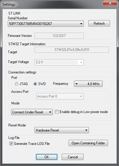

I use SWD interface to configure my STM32 board.
It all worked out, but I changed #define and moved to a part of the program that disabled the sw interface.
Now my STLINK/V2 can not connect to the device.
Do you have an idea to erase the chip or restore the SWD interface?

    Or connect under reset.

    Reset with BOOT0 pulled high, and erase ​

    Thank to you too @Community member​  @Uwe Bonnes​
    I don't try the first method because i've a 0402 resistance in pull down but it could have been done if necessary.
    Just to configure ST-LINK in another way
