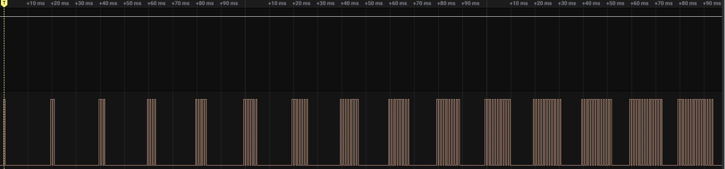

I am trying to generate required no of pulses using PWM. This is to implement to control stepper motor with position control.
I use HAL_TIM_PWM_Start_IT to start pulsing and count the no of pulses in HAL_TIM_PWM_PulseFinishedCallback.
I notice that the more the required pulses, the more the extra pulses will be generated. And also higher frequency will generate more extra pulses.
Attached is the initilization of the timer and call back function when the interrupt occur.

To be able to set more than 256 pulses in a single shot, you can use other options, like DMA, or a slave timer.
I think the slave timer option is the best in this case, as the PWM value stays always the same (50% in this case), you only want to send pulses to a motor.

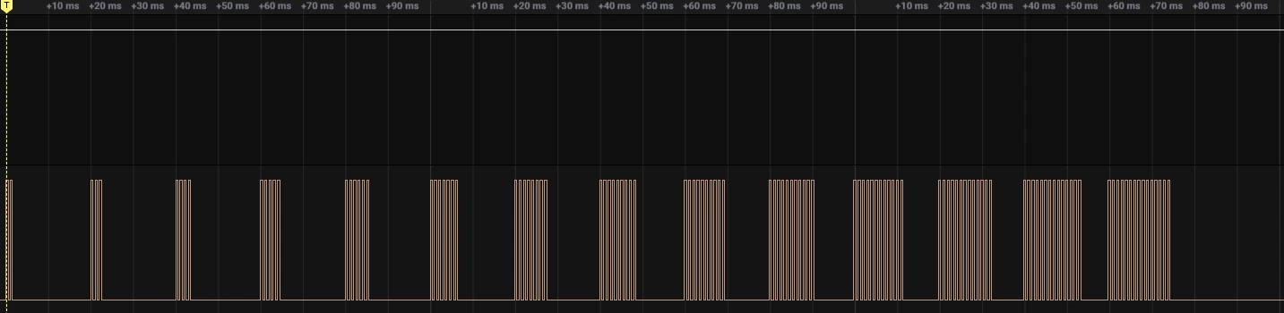

I attached two sample projects. They make 15 pulse trains, from 1 to 15, and stop.
Both use Timer4 to make 1KHz PWM signal.
In both cases, only one interrupt is generated (at the end of the pulses), so it's very CPU efficient.
These pictures are real, taken with the logic analyzer.
The waves are perfect, the jittering you see is because of the low zoom.
The DMA method can make up to 65536 pulses (DMA transfer limit).
It uses normal mode DMA, but disabling memory address increase, so it sends N times the same value.
The slave timer method uses Timer2 (32-bit) in slave mode, so you can send up to 4294967296 pulses. But not only 1, it causes weird behaviour.
The Timer 4 operates silently, no interrupts, but increasing Timer2 on every PWM cycle.
Timer2 increases in the exact moment that PWM goes low, but Timer4 didn't reset yet, still has to finish the low part of the PWM period.
So when Timer2 resets, you have plenty of time to enter the interrupt and stop Timer4 before the next PWM cycle starts.
