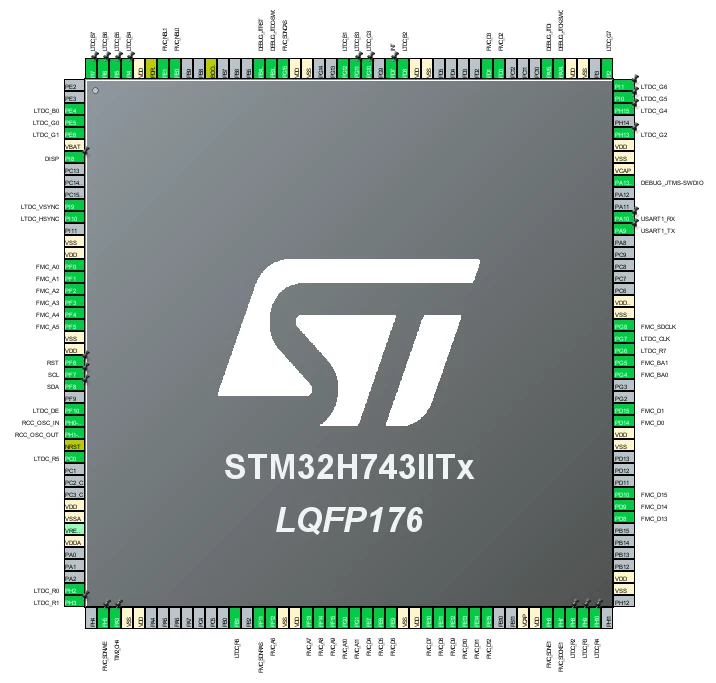

eerni
Visitor II
Sep 29, 2021 3:53 AM UTC
hi Tesla Delorean
i need w25q256fv stldr for h743i.
the loader that you upload for this, erased successfully, but not validate erase...
can you help me and share the source of the w25q source project or generate
CLIVEONE-W25Q256FV_STM32FHXX-PB2-PB6-PF8-PF9-PF7-PF6
for me.
thank
