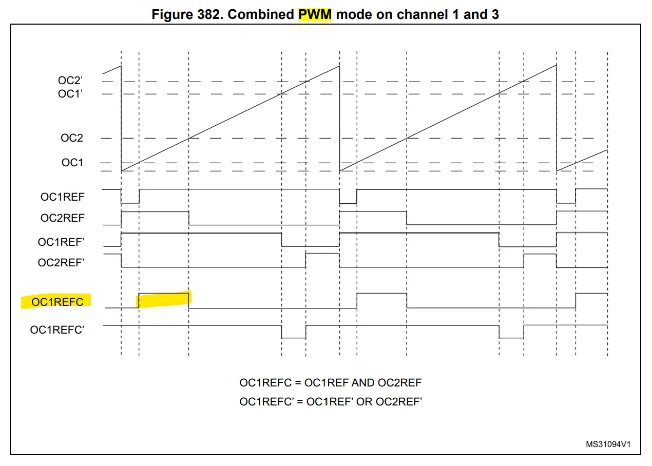

Perhaps the easiest is to use the scheme that almost works except use PWM mode 2 and set it so output is low at CNT=0, high at CNT=1... X, and then low again until it reaches ARR.
If you need them to exactly match, you could use TIM8 in gated slave mode to get exactly 4 pulses at the start of each TIM1 period. Can describe this more if you need.

Ah the combined mode, I hadn't considered that but I'm sure that will work. The single count offset is no problem. Thanks a lot!

// Basler: The Basler camera is triggered by a combined PWM mode, to ensure a low level at the end of the frame triggers,
 // while still (almost, at CNT=1) starting high.
 // 12: Combined PWM mode 1 - OC1REF has the same behavior as in PWM mode 1. OC1REFC is the logical OR between OC1REF and OC2REF.
 // 13: Combined PWM mode 2 - OC1REF has the same behavior as in PWM mode 2. OC1REFC is the logical AND between OC1REF and OC2REF.

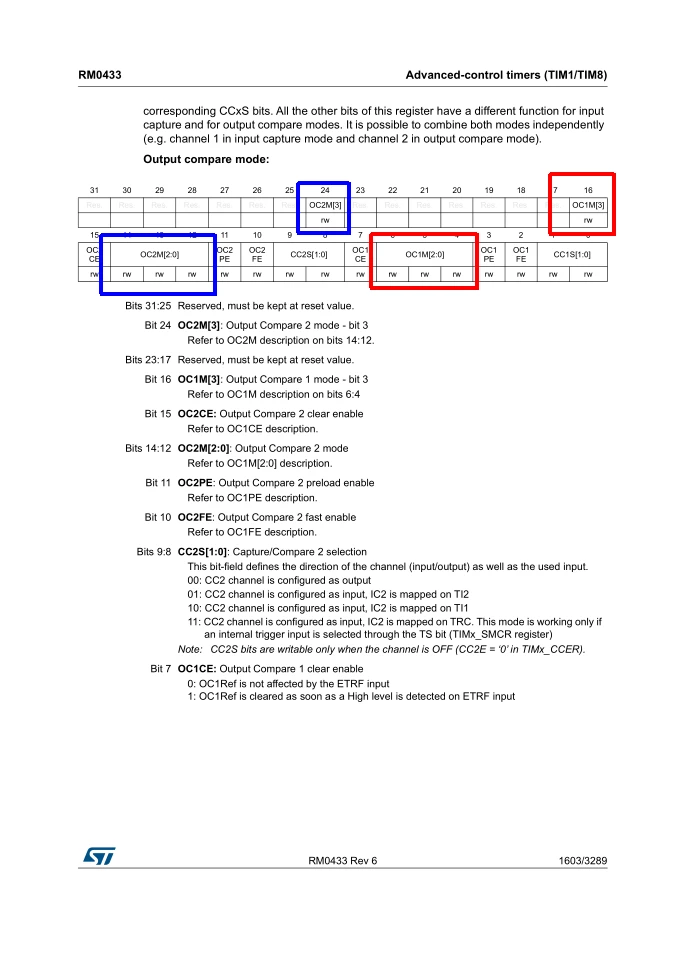

 TIM8->CCMR1 &= ~TIM_CCMR1_OC1M_Msk; // for TIM8_CH1 - AND
 TIM8->CCMR1 |= (0x13UL << TIM_CCMR1_OC1M_Pos); //
 TIM8->CCMR1 &= ~TIM_CCMR1_OC2M_Msk; // for TIM8_CH2 - OR
 TIM8->CCMR1 |= (0x12UL << TIM_CCMR1_OC2M_Pos); //
1. 0x12/0x13 != 12/13
2. TIMx_CCMRx.OCxM bits don't form a continuous bitfield (for historical reasons)
