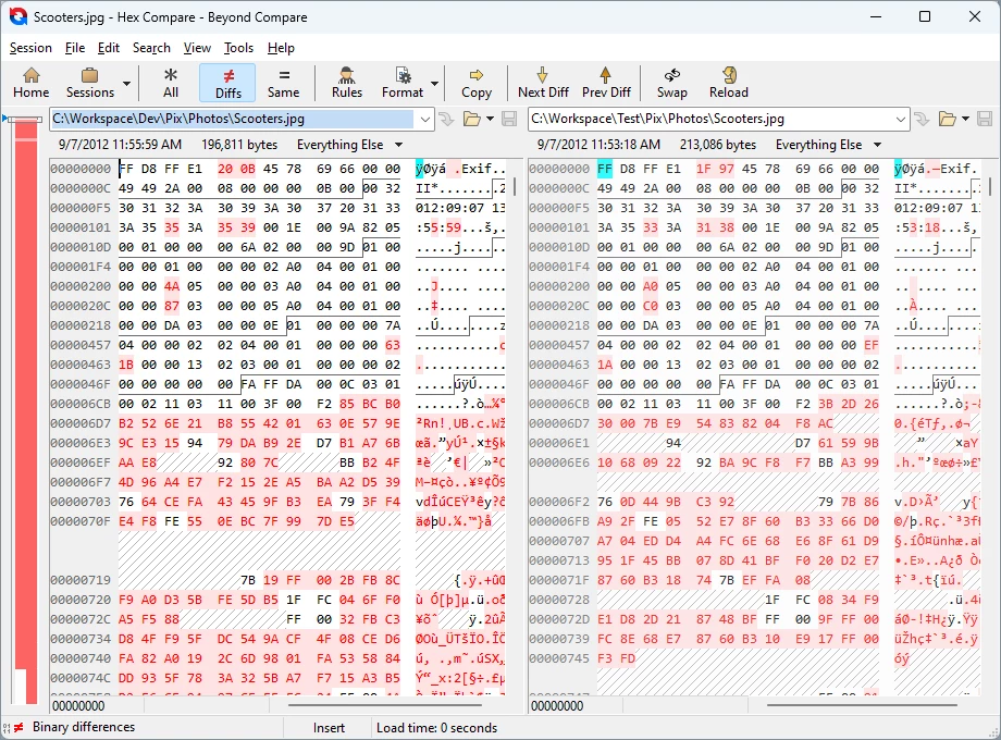

As I said, do what to do with linker file and do the HEX file comparison. I suggested  Beyond Compare as it's an efficient tool in HEX compare: https://www.scootersoftware.com/v5help/viewhex.html
See for studying HEX file format:
https://developer.arm.com/documentation/ka003292/latest/
https://en.wikipedia.org/wiki/Intel_HEX

 "After modifying the linker file, I want to see these changes reflected in the HEX file" do a diff between the HEX files using for example Beyond Compare tool. It can do HEX file comparison.

I received an internship task where I need to compare two HEX files by modifying the address stored in the linker file. Therefore, I need to analyze the HEX files. I am currently using a text comparator to compare them, but I am not very proficient in changing the address. After observing these changes, I will try to analyze the variables with addresses I have defined myself on the HEX file.
