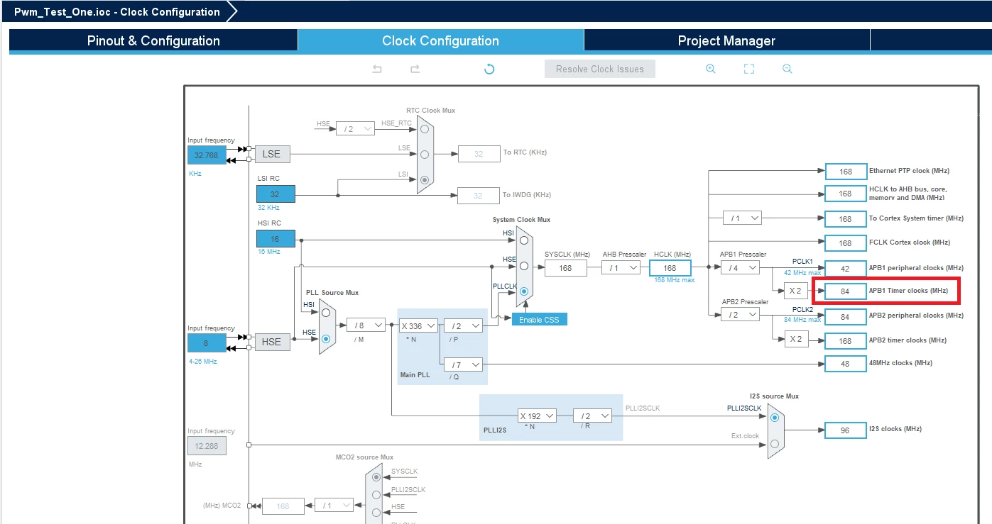

The timer clock is configured to 84 MHZ

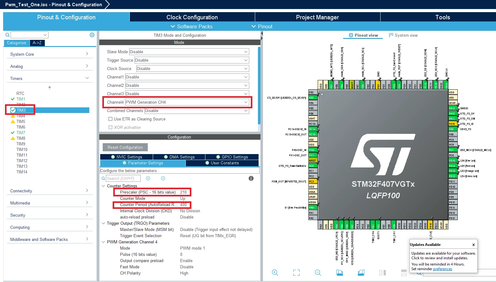

I am using TIM3 on channel 4. The prescaler is 210 and the counter period is 400 =>
84000000 / 210 / 400 is 1000 HZ

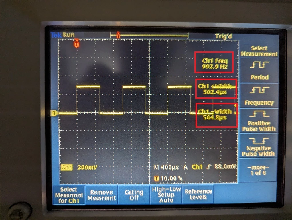

Here is what I am seeing on the scope:
As you can see the frequency is 992.9 HZ.
I am trying to understand the resolution and why it is not 1000 HZ?

Values for Prescaler and Period are N-1, you created  84000000 / 210+1 / 400+1 is  992.78 HZ
You want 210-1 and 400-1, the 50/50 point is still 200
For best resolution / granularity in width make the Prescaler as small as possible, and the Period as large as will fit in 16-bit TIM3
