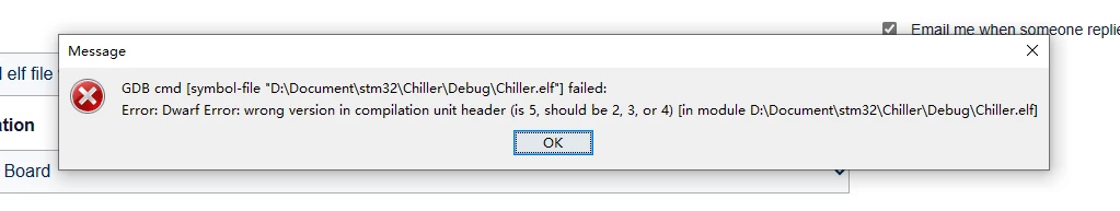

Generated elf file version two high that stm studio not support?
It seems that stm32cubeide generated elf file not support in many application. So is there any way to solve this issue?

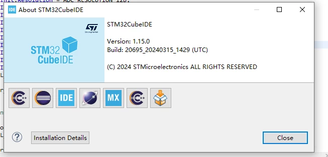

    The CubeIDE version is 1.15.0 but 1.14.0 seems have the same problem.

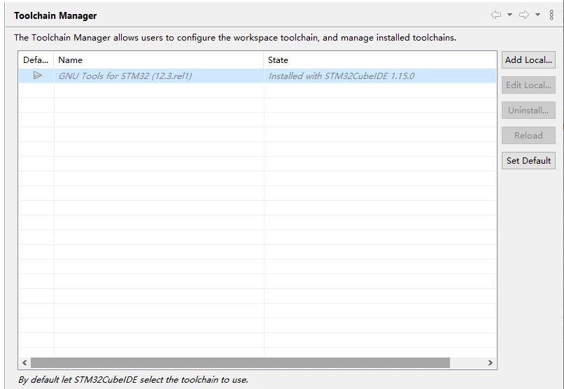

    The toolchain is default. I try to append a c-flag '-gdwarf-2' but still not working.

    It seems that the issue is related to the upgrade to GCC 11,
    I suggest that you use the GNU Tools for STM32 (10.3-2021.10)

    The previous version like version 1.7.0 is still working. But many application still not support elf 5. So the next generation will fix this issue?
