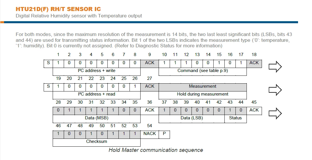

generate an ack bit after the data reception in I2C master mode.
hello,
  I'm trying to interface the temperature and humidity sensor (HTU21D RH/T) which is based on the I2C interface. As referring to the given datasheet of the following sensor ( https://cdn-shop.adafruit.com/datasheets/1899_HTU21D.pdf ), in order to read the temperature or humidity's value I need to send an "ack bit" after reception of each 8bits data. I've tried to do this on my own but I'm not sure whether I'm arranging the commands (functions, flag, etc) in a proper sequence.
note* please refer the image file which is being attached along below.
thanking with regards
Aatif Shaikh

    Seems like a relatively normal expectation for an I2C device..
    Might want to use 0x80 for the address and not 0x40, ST passes the top 7-bits
    The Slave should ACK if it recognizes the address presented, if it fails to respond to that you have the address wrong.
