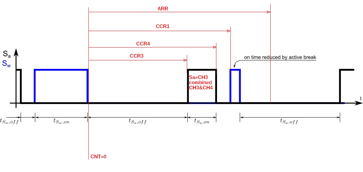

Hi ST community,
For a project I would like to generate two interdependent PWM signals (Sa and Sw in the attached figure) with the STM32G0. The constraints/tasks are as follows:
  • tSw,off = constant for ~100ns
  • tSw,on = in a time range from ~100ns to 20us and is limited cycle by cycle by an active break (peak control application).
  • tSa,off = set every 300us in a time range from ~100ns to 30us.
  • tSa,on = is set every 300us in a time range from ~100ns to 5us.
The times for tSa,off and tSa,on are thus adjusted every 300us. The time tSw,on is limited cycle by cycle by the active break.

  • Use a single timer with CH1 and CH3 in combined PWM mode 2.
  • Set CCR1/CCR2 appropriately to get the first (blue) pulse on CH1
  • Set CCR3/CCR4 appropriately to get the second (black) pulse on CH3
  • When changing values, wait until the timer just rolls over, so it's in the tsw_off stage, and change all CCRx at once, quickly, with interrupts disabled.

waclawek.jan
October 18, 2023
Timer period starts at beginning of Tsa,off. Tsa,on generated using Combined PWM mode as TDK said above. Tsw,on normally generated using the plain PWM2 mode on one channel, as timer period ends with end of Tsw,on.
Premature end of Tsw,on accomplished through feeding COMP output to TIx or ETR (see TIMx_TISEL or TIMx_AF1 registers), setting that signal as Slave-mode controller's input (TIMx_SMCR.TS) and setting Slave-mode controller to Reset in TIMx_SMCR.SMS.
Update all required TIMx_CCRx together with TIMx_ARR in Update interrupt (or learn how to use Update-triggered "burst" DMA through the TIMx_DMAR/DCR mechanism). Enabling ARR/CCRx preset (TIMx_CR1.ARPE & TIMx_CCMRx.OCxPE) helps.

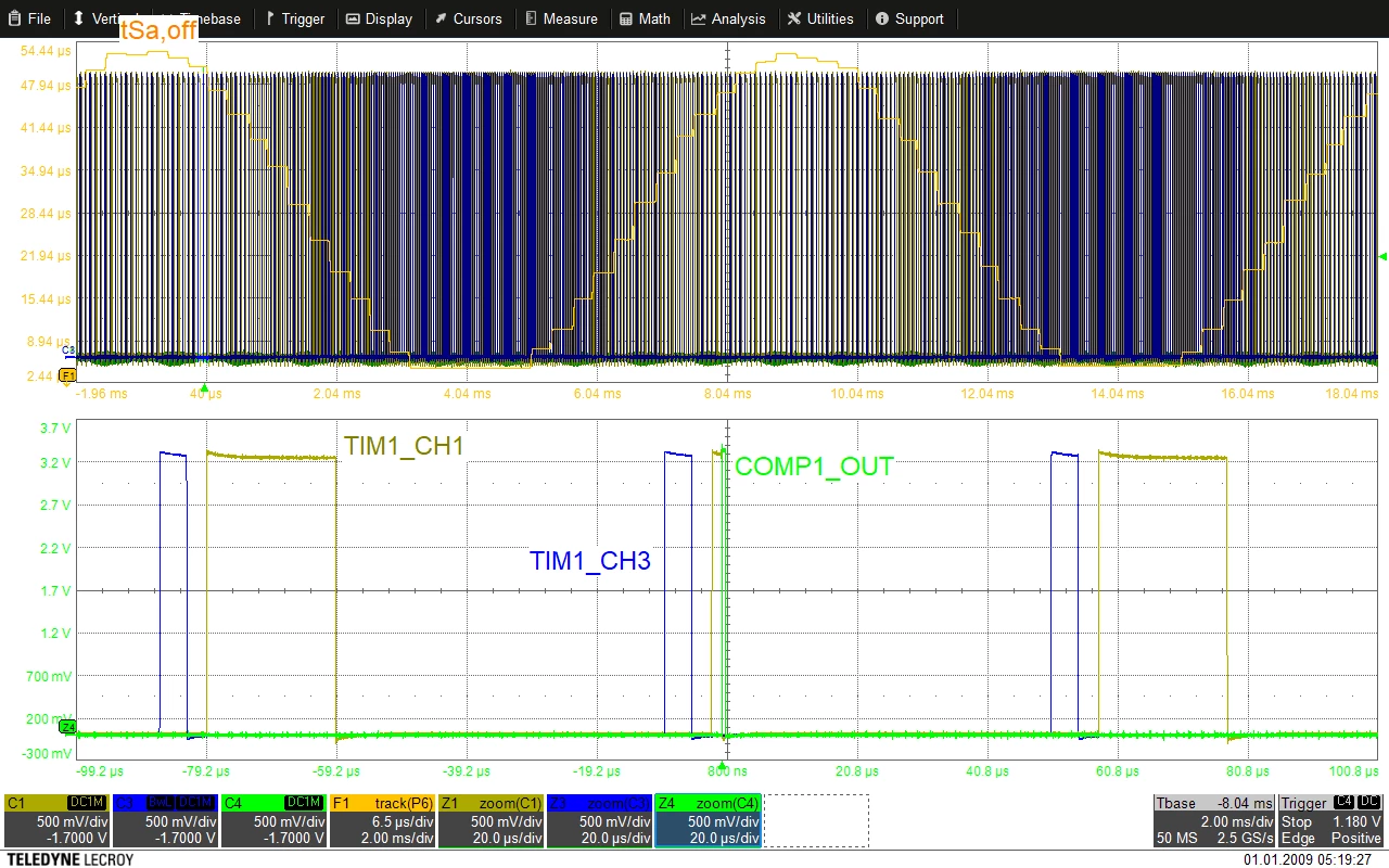

I tired to follow your instructions and implement this code after I started the combined PWM:
 TIM1->AF1  |= TIM1_AF1_ETRSEL_0;               // SET COMP1 output as ETR input source
  TIM1->SMCR |= 0x70;                                        // Set Bit 4,5 and 6 to ue ETR as trigger input
  TIM1->SMCR |= 0x4;                                         // Set slave mode selection (SMS) to Reset mode
In the attached screenshot you can see the first small signal measurements. In yellow (C1) the output of TIM1 channel 1, in blue (C3) the output of TIM1 channel 3 and in green the output of the COMP1. As you can see, the  comparator output limits the on time of TIM1 channel 1 (as expected) and it looks like that the CNT is also reset in this case (because of the missing TIM1 channel 3), which is also somehow expected, because in the RM0444 the SMS description mentions this for the Reset mode. But this is not an option for the final application. As shown in the picture of the first post, after a limited tSw,on the defined tSa,off should occur. Any hints to improve this?

Stefan Stark
October 24, 2023
Based on your drawing, I tried to implement both signals within the combined PWM.
- Sw: TIM_CH1 = CCR1 & CCR2 (where CCR2 = ARR)
- Sa: TIM_CH2 = CCR3 & CCR4
The ETR configuration remains the same.
In the software I update the registers every 300us. As you can see in the figure below, the tSa,off (orange) graph changes as expected without unexpected jumps (NICE).
I also tried to simulate a break situation of the tSw,on. The comparator output limits the on-time of TIM_CH1 as expected without changing tSw,on or other timings.
But if I understand you correctly, your idea was to run the Sa with the combined PWM function and the Sw with the PWM2 mode. I have tried this and it works as well. Why do you prefer this approach? Because with this approach one register less has to be written?
