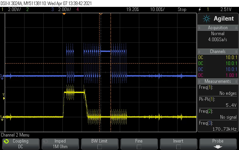

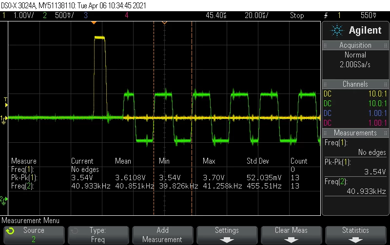

i try to implement a 40kHz frequency burst with my NULCEO STM32F411RE. Until now i toggle the GPIO continuously in the HAL_TIM_PWM_PulseFinishedCallback function. But now i have to implement a start Trigger to do a small 40kHz burst. In the attached picture where you can see the yellow start trigger which should start my burst signal. To be flexible with the amplitude, i used the external DAC MCP4921. But as you can see (green signal), sometimes the code is executed faster, which generates a phaseshift. Thats why i want to implement this burst with an GPIO, but i will lose the functionallity of an flexible amplitude. I tried to use the Status Register UIF bit (Update interrupt flag) , which generates an impluse when the counter has overflown. but the result is not 40kHz (scope_4 blue signal). I changed the prescaler of my timer but nothing changed. I guess i have to use a different method.
void PM(void)
  GPIOA->BSRR = (1<<24);;
 for(int p=0;p<=40;p++)
 if(TIM2->SR & 0x01)
 GPIOA->ODR ^= (1<<8); //Toggle output GPIOA PA8
This is the function right after i read the yellow trigger Signal with
if(HAL_GPIO_ReadPin(I_Trigger_GPIO_Port, I_Trigger_Pin)== GPIO_PIN_SET)
How i could use the 40kHz of TIM2 to toggle my GPIO

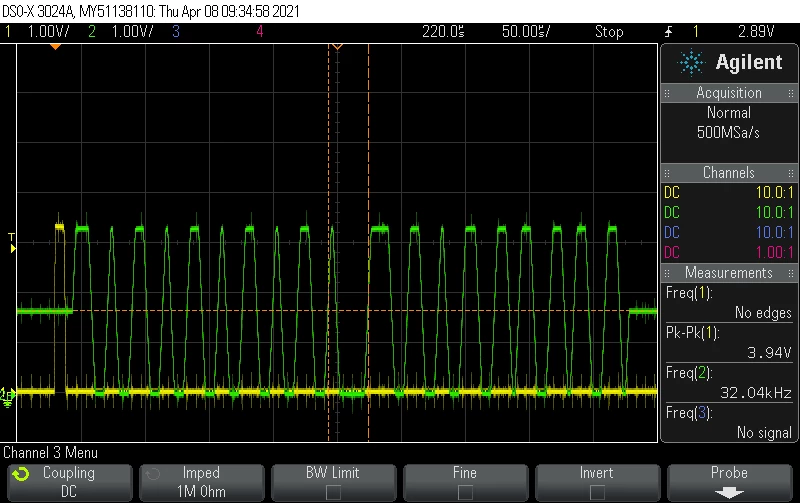

Walter Nazarenus
April 8, 2021
It should have 10 pulses bevore and 10 after the phaseshift. Doesnt matter if the pulse is two pulses high or low. I attached the output of the DAC. But now i want to realize this with timer and Gpio, to get a more accurate frequency
