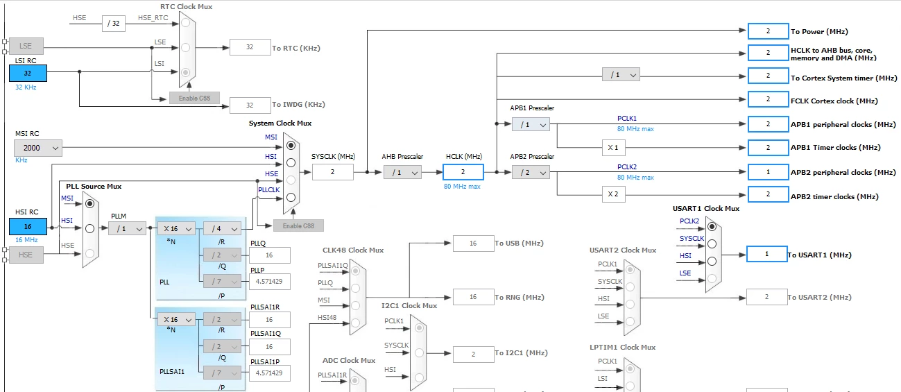

I'm using TIM1 and TIM2 of the L432KC. In the clock tree, I see APB1/APB2 peripheral and timer clocks bus frequencies. I thought that when I set a prescaler, the APBx timer clock frequency is the one divided by the prescaler, but actually is the APBx peripheral clock frequency. What's the real difference?

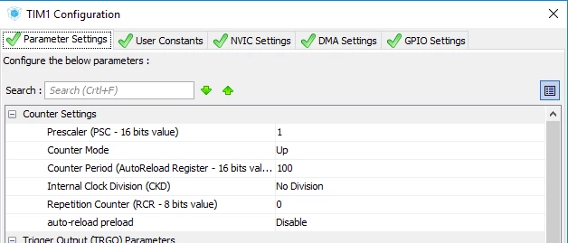

    Sep 27, 2018 5:14 PM UTC
    @Khouloud GARSI​
    Attached are my clock tree and timer setting for PWM 10 kHz on Timer 1 Channel 1. As you can see my prescaler is 1, so it's taking the 1 MHz instead of 2 MHz from APBx Timer Clocks.
    Khouloud GARSI
    Sep 28, 2018 9:27 AM UTC
    Hi @XP.1acheco​ ,
    In your case the APB2 timer clocks is equal to 2MHz.
    Below is the equation that we use to calculate the frequency:
    PWM Frequency = [Timer Fresuency ] / [(Prescaler+1)*(Period+1)] ; Since your Prescaler is one, the frequency will be divided by two (prescaler+1).
    In order to have your expected frequency you should set the timer prescaler to 0.
    Khouloud.

    If I want 10 kHz, then applying the formula with prescaler one and counter period 99 I have:
    PWM Frequency = [2 MHz] / [(1+1)*(99+1)] = 10 kHz
    Why do you say my prescaler should be 0?
    Let me see if I understood the concept: APBx timer clocks are specifically for timers, and APBx peripheral clocks are for the other peripherals, right?
