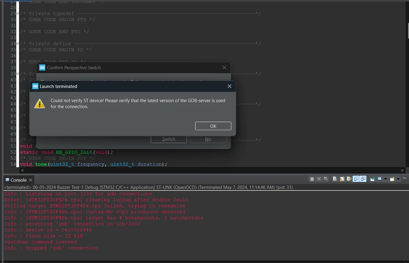

GDB-server openocd
Could not verify ST device! Please verify that the latest version of the GDB-server is used for the connection.
Open On-Chip Debugger 0.12.0-00024-gc3ff39f8b (2023-06-26-16:51) [https://github.com/STMicroelectronics/OpenOCD]
Licensed under GNU GPL v2
For bug reports, read
	http://openocd.org/doc/doxygen/bugs.html
Info : Listening on port 6666 for tcl connections
Info : Listening on port 4444 for telnet connections
Info : STLINK V2J43S7 (API v2) VID:PID 0483:3748
Info : Target voltage: 3.308456
Info : Unable to match requested speed 8000 kHz, using 4000 kHz
Info : clock speed 4000 kHz
Info : stlink_dap_op_connect(connect)
Info : SWD DPIDR 0x0bb11477
Info : [STM32F030F4Px.cpu] Cortex-M0 r0p0 processor detected
Info : [STM32F030F4Px.cpu] target has 4 breakpoints, 2 watchpoints
Info : starting gdb server for STM32F030F4Px.cpu on 3333
Info : Listening on port 3333 for gdb connections
Error: [STM32F030F4Px.cpu] clearing lockup after double fault
Polling target STM32F030F4Px.cpu failed, trying to reexamine
Info : accepting 'gdb' connection on tcp/3333
Info : device id = 0x10006444
Info : flash size = 32 KiB
shutdown command invoked
Info : dropped 'gdb' connection
Error message above have given is there any solution

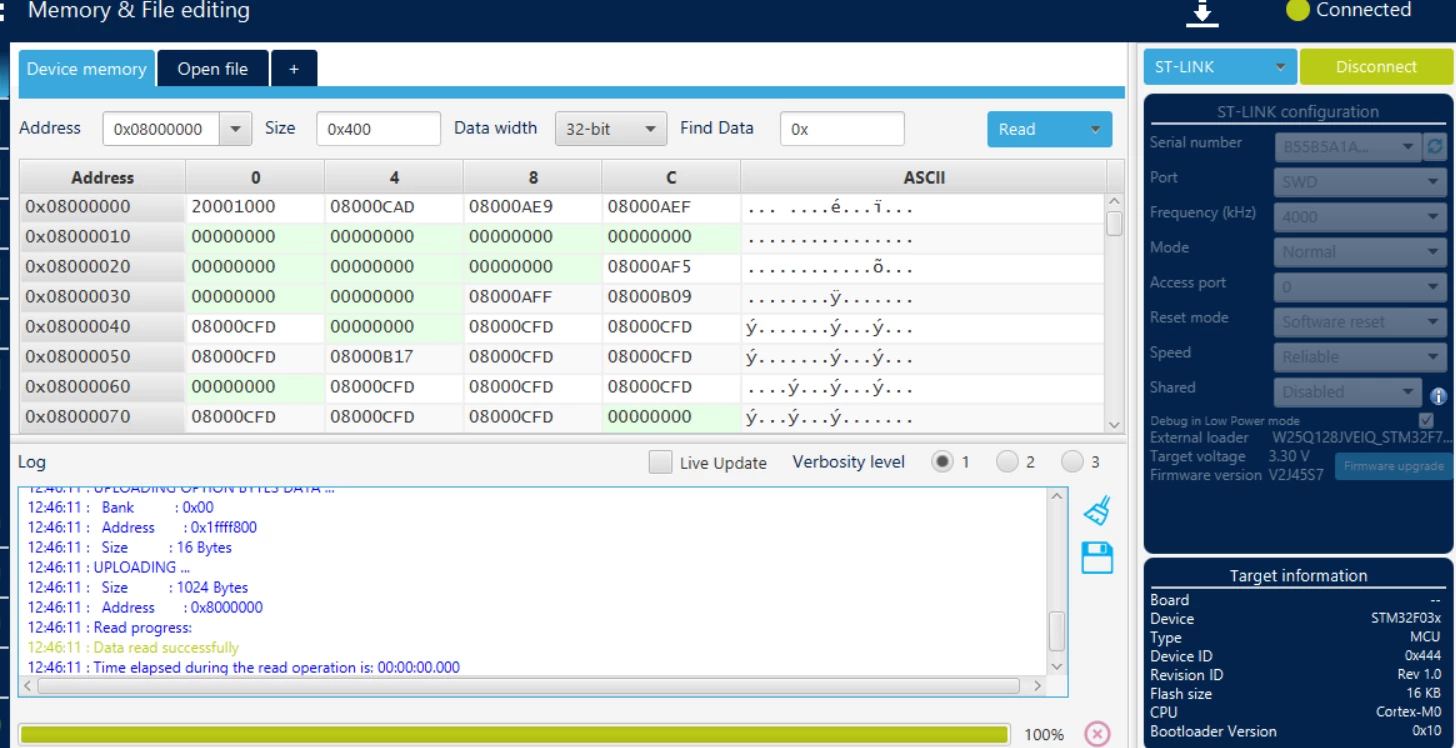

Show , whats STM32CubeProgrammer telling :
July 15, 2024

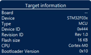

 Afte connect to  STM32CubeProgrammer  this is what i able to gat

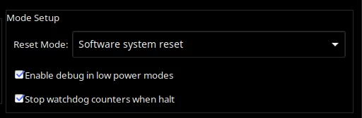

AScha.3
July 15, 2024
Good !
so we see:

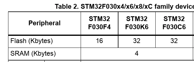

...connected to F03xx  , ID 0x444 , rev 1.0 .
Flash 16KB  -> but you have in IDE flash size 32KB !  So someone wrong here...sure, you set it to the version of chip, you really have here (16KB) ?

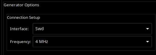

or - if you set in IDE correct F030F4 for your project, set connect "software reset" -- but debug still not working:
try using the open ocd debugger, just set it in debug settings:
