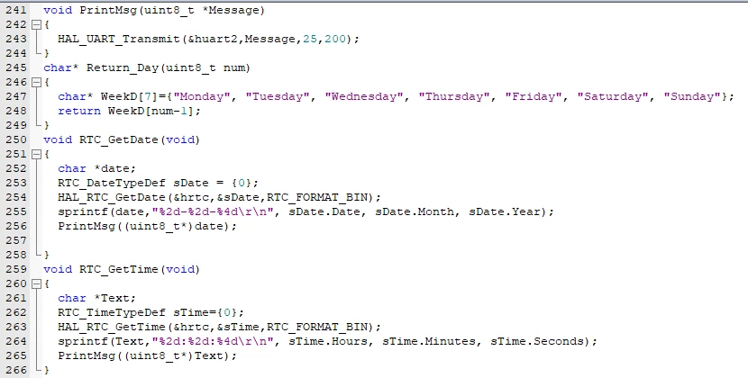

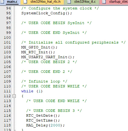

hi everyone,
Can someone tell me if sprintf is ok in Keil? Tera term prints garbage value.
2 days ago I tried sprintf and it didn't work, I tried a simple declaration of a string and it worked.

    It's ok, I found it :D
    Piranha
    Principal III
    December 10, 2019
    You must provide an array to it, not uninitialized pointer.
    Also take a note that sprintf() is unsafe, because it isn't aware of output buffer size. Better use snprintf().
