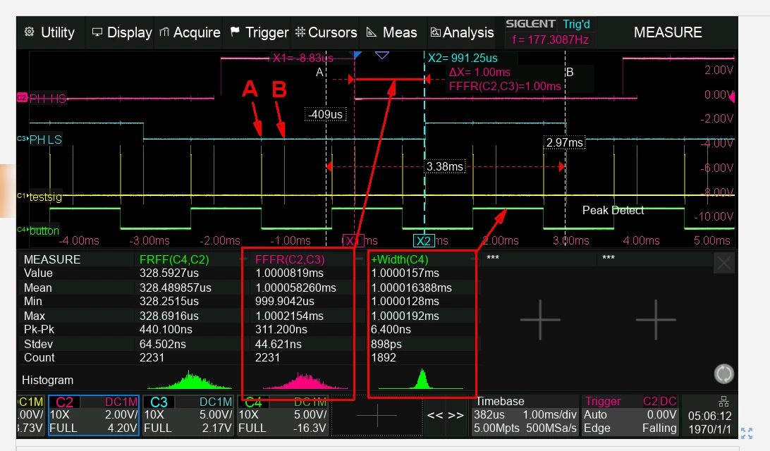

I have timer 1 to use with hall sensors as interfacing timer. Timer 8 is then used to output the signals (see picture red and blue).
The simulated hallsignal (3 sensors combined) is very precise and pretty constant (green signal - second box).
"A" shows the interrupt test signal from the input interrupt. "B" is the interrupt from CCR2 of timer 1 that does actually nothing, but shows where the output signals should change.
The first box shows the interval between those 2 high levels of the outputs of timer 8.
The delay from A to B is set to be constant. I have already came across the problem of resetting the counter and prescaler of timer 1, so that is not an issue anymore.
What else would there be, that would cause such a fluctuation? Interrupts should not be critical, as the stuff is happening in the background?
My loop() is empty.
