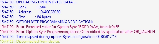

Among 20-odd PCBs populated with STM32G431CBUx controller, I am facing issue in programming one of them. All the others works fine, with no issues what so ever.
The RDP is set to 0xFF, and the BOOT_LOCK bit was set. I searched through the community posts and tried the following methods.
  1. Set the BOOT0 pin High and enter through “Under Reset” mode → try to reprogram RDP to 0xAA.
  2. Try resetting through NRST and then reprogram the option bytes

15:43:13 : Option byte command : -ob BOR_LEV=1 BOOT_LOCK=0 nSWBOOT0=0
15:43:13 : qCmd : -ob BOR_LEV=1 BOOT_LOCK=0 nSWBOOT0=0
15:43:13 : PROGRAMMING OPTION BYTES AREA ...
15:43:13 : Bank : 0x00
15:43:13 : Address : 0x40022020
15:43:13 : Size : 84 Bytes
15:43:14 : Reconnecting...
15:43:15 : Reconnected !
15:43:15 : UPLOADING OPTION BYTES DATA ...
15:43:15 : Bank : 0x00
15:43:15 : Address : 0x40022020
15:43:15 : Size : 84 Bytes
15:43:15 : OPTION BYTE PROGRAMMING VERIFICATION:
15:43:15 : Error: Expected value for Option Byte "BOOT_LOCK": 0x0, found: 0x1
15:43:15 : Error: Option Byte Programming failed Or modified by application after OB_LAUNCH
15:43:15 : Time elapsed during option Bytes configuration: 00:00:01.184

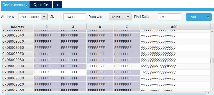

When I tried to read the flash, I expected 0xFF. However, in few areas, I was reading different values.

Typically indicates the option bytes were not read correctly, rather than them actually being 0xFF.
Can you program the flash?
If it were my board, I would reflow the MCU and relevant components.

I cannot program the flash. I am getting read failure, indicating RDP being programmed to 0xAA. I could not reprogram the RDP as well.

Try to use command to modify RDP independently. Not to program whole the OB at the same time with RDP.
Find out the location of STM32_Programmer_CLI.exe. Execute that,
STM32_Programmer_CLI.exe -c port=SWD mode=UR -rdp 0xAA
After flash has been totally erased, program OB again if you want to.
