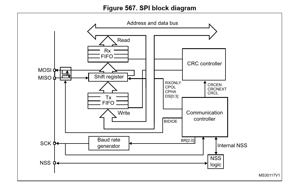

G431 SPI - bits are not set.
First time i set up SPI, not using HAL.
In the debug, i see that not a single bit is set.
What am i doing wrong?
 SPI_HandleTypeDef spiHandle;
 spiHandle.Instance = SPI2;
 // SPI_CR1_CPOL
 SET_BIT(spiHandle.Instance->CR1, SPI_BAUDRATEPRESCALER_256);
 // CPOL = 0
 SET_BIT(spiHandle.Instance->CR1, SPI_POLARITY_LOW);
 // CPHA = 1
 SET_BIT(spiHandle.Instance->CR1, SPI_PHASE_2EDGE);
 // MSB is default
 // We are Master
 SET_BIT(spiHandle.Instance->CR1, SPI_MODE_MASTER);
 // Active SPI
 SET_BIT(spiHandle.Instance->CR1, SPI_CR1_SPE);
 // Frame length
 SET_BIT(spiHandle.Instance->CR2, SPI_CR2_DS_2 | SPI_CR2_DS_1 | SPI_CR2_DS_0);
 // SS output
 SET_BIT(spiHandle.Instance->CR2, SPI_CR2_SSOE );
Tobe
TobeBest answer
Senior III
March 30, 2024
This is the solution:
SET_BIT(RCC->APB1ENR1, RCC_APB1ENR1_SPI2EN);
It was not mentioned in the SPI instructions...

AScha.3
March 30, 2024
G4xx SPI is not so complex :
Maybe easy way: setup with Cube, then just write to DR ( SPI2->DR ) , as i do, to send.  :)
(But i have no G4xx , just F303, etc. SPI seem same. On H7 or H5 its another game ! )
