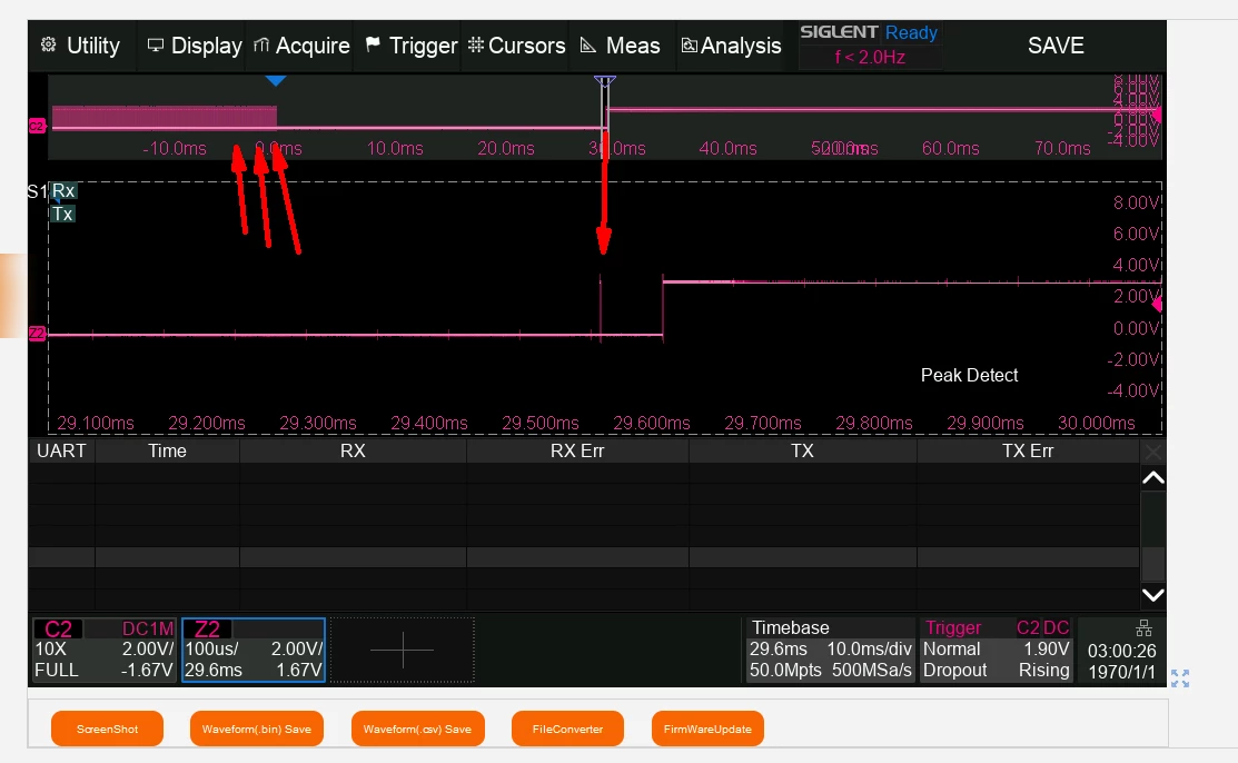

G431 does not behave as expected, when debugging a breakpoint in interrupt
I have a breakpoint in the interrupt, but when i debug this point, the scope does not show the signal (red) as expected.It should be high and not low, as you can see in the picture.

No stop bits are set. Only DGB_SLEEP, DGB_STOP and DGB_STANDBY.
Why would it stop, and then take 30ms to get into the interrupt? That is a long time, also for debugging i would say. Then debugging would not really work on this point, as there is stuff beeing executed 30ms away, form where it should have happend.

You have never explained what is "red signal", what's the expected behaviour and why do you think it's different from the observed one; e.g.
I see it being both low and high, successively.
Also, you did not explain, why do you think it takes 30ms to get interrupt.
So, I was left with a guess. And, guess what, that guess was incorrect.

The red signal shows the interrupt activity (high for inside of interrupt).
The program (debugger?) does stay out of the interrupt for 30ms (read from scale of scope) when it should not (green line is input for interrupt).

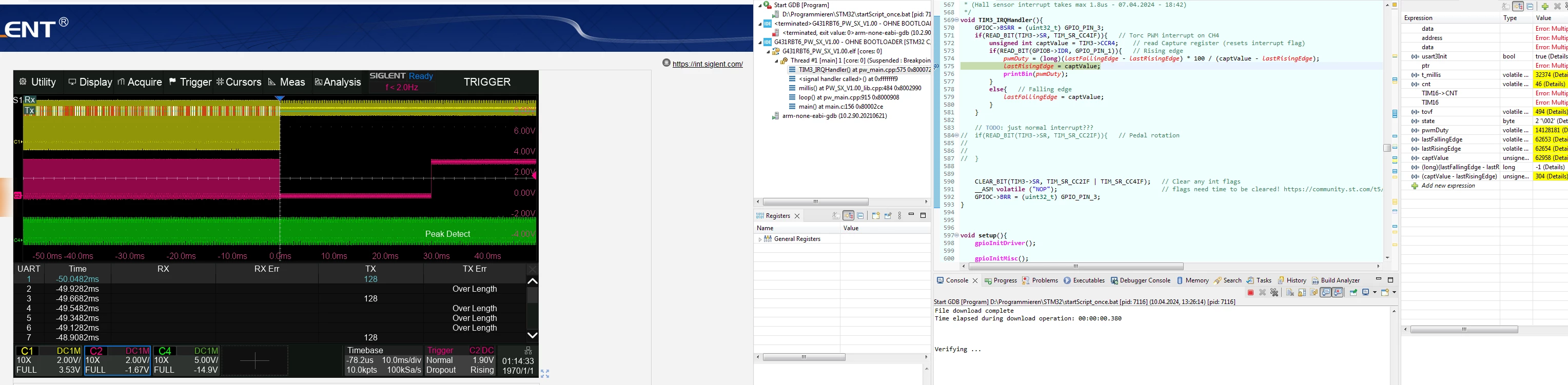

Now i have attached another picture:
The program stays outside of interrupt for 30ms, but then fires one interrupt, leaves the interrupt, but then goes back into it again and stops at the breakpoint.
OK so you have some program - e.g. interrupt with higher or same priority as the interrupt in question - which lasts 30ms under some circumstances.
Or, if you've just clicked breakpoint in the debugger at that moment, it might've been that the debugger stopped execution for 30ms so that it could insert the breakpoint.
