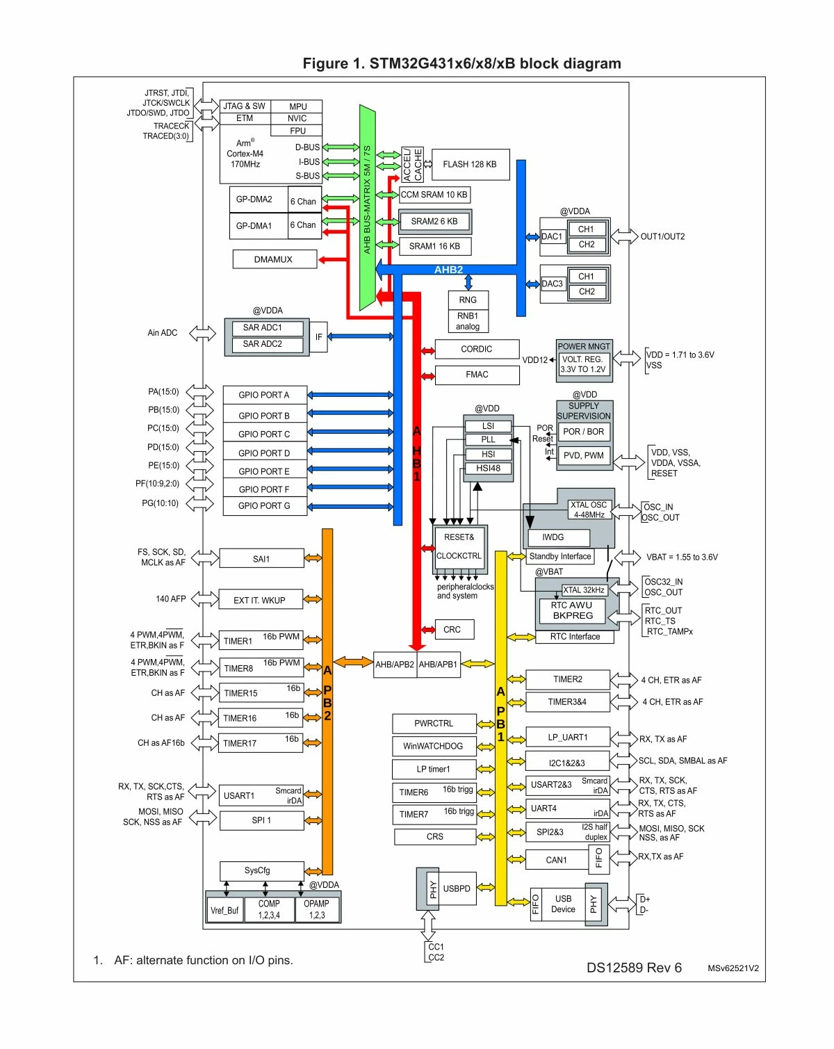

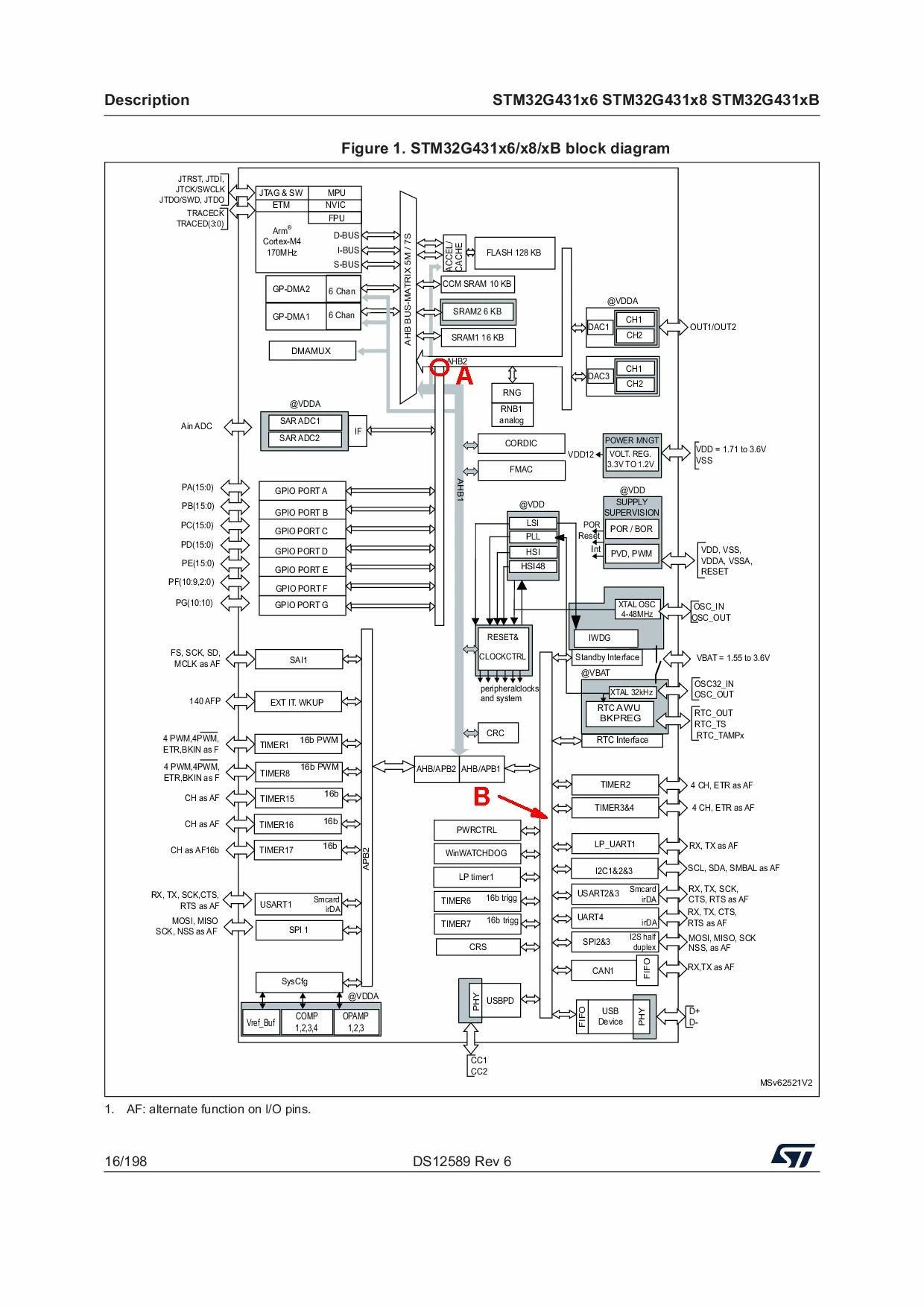

i have two questions here:
A: That line should not be there, so the bar downwards would be the AHB2?
B: This is APB1?
3 replies

you talking about ...?
this: ?
Tobe
TobeAuthor
Senior III
November 28, 2023
Yes, i forgit to include it. I just added it.

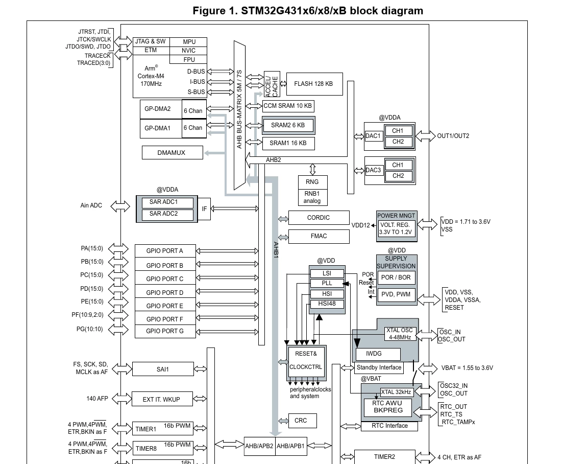

Tobe
TobeAuthor
Senior III
November 28, 2023
Take this with you: (it should be right i think)
KDJEM.1
Technical Moderator
November 28, 2023
Hi @Tobe ,
I confirm the issue and I reported internally.
Internal ticket number: 167372 (This is an internal tracking number and is not accessible or usable by customers).
Thank you for your contribution in STCommunity :).
