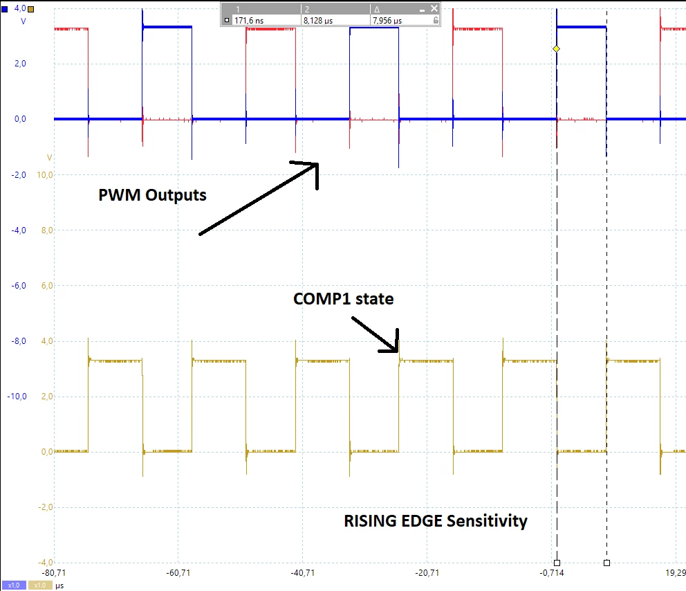

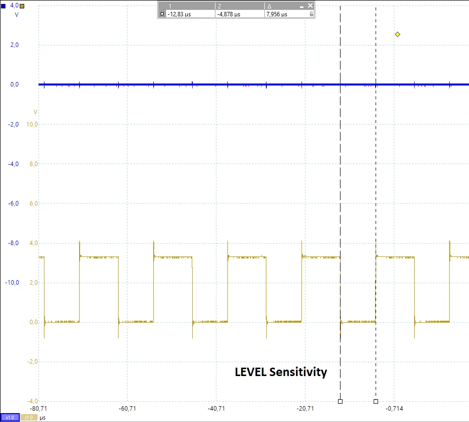

I'm currently using HRTIM on a STM32G474RE and I'm facing a configuration problem.
Context :
The HRTIM is used to produce 2 push-pull PWM outputs from Timer A. The 2 outputs are configured the same way :
  • 1 Set source : Timer period event
  • 2 Reset source : Timer compare 4 and External Event 4.
External Event 4 is configured with the following logic :
  • Source : COMP1 out
  • Polarity : High
  • Sensitivity : LEVEL
  • FAST MODE : disabled
More over, this external event is filtered using a "blanking", generated from compare 1 timer unit. Event is ignored if it happens during the blanking.
The problem:
In this configuration, the outputs stays at low level, no matter the state of COMP1.
If I change the sensitivity of the external event, I get the desired output. PWMs are resetted as soon as COMP1 is high.
Any suggestions ?
Thank you :)0693W00000Hpkm1QAB.png0693W00000HpklcQAB.png

What's the value about CMP4?
According to RM0440 Chapter 27.3.7,When set and reset requests from two different sources are simultaneous, the reset action
has the highest priority.
COMP1_OUT high level duration is 7.956us, in this time may will generate Timer period event(1 Set source).
If all the Timer period event generate in COMP1_OUT =High, PWM output will always LOW.
you can set more than one SET source test it again.
