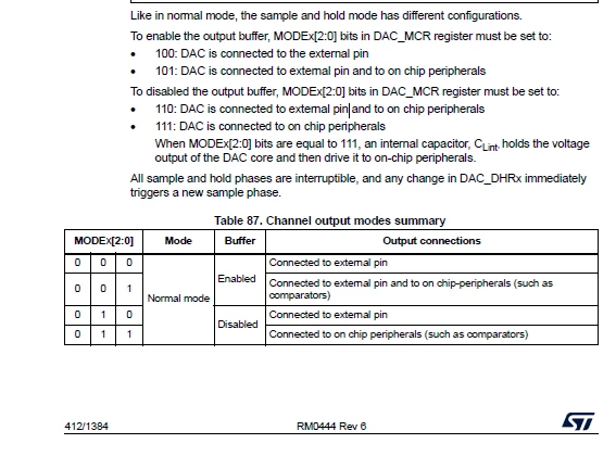

I’m currently testing on a Nucleo-G071RB and will eventually port everything to a custom board based on the STM32G071GBU3. As you suggested, I tried to bit-bang PA4—but while I could control other pins, PA4 wouldn’t toggle. Could this be related to the DAC?
I’m using DAC channel 1 as the COMP negative input.

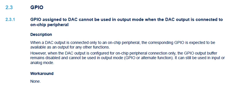

waclawek.jan
Aug 4, 2025 5:20 PM UTC
Indeed, that will be it, as a consequence of the GPIO assigned to DAC cannot be used in output mode when the DAC output is connected to on-chip peripheral erratum.

I rechecked the reference manual, and it states that setting the DAC_MCR MODE register to 0b011 disables the buffer and routes the DAC only to on-chip peripherals. I confirmed in the debugger that DAC1_CH1.MODE is indeed set to 0b011, so is it still impossible to use PA4 with other peripherals under these conditions?
waclawek.jan
Aug 5, 2025 8:09 AM UTC
Errata explain deviations from the reference manual (which describes the design intention), thus errata "override" the manual.
Have you read the quoted erratum?
HYosh.2
HYosh.2AuthorBest answer
Aug 5, 2025 3:48 PM UTC
I overlooked the note in the attached section. I’ll look into disabling the DAC during SPI transmissions. Thank you for your support.
