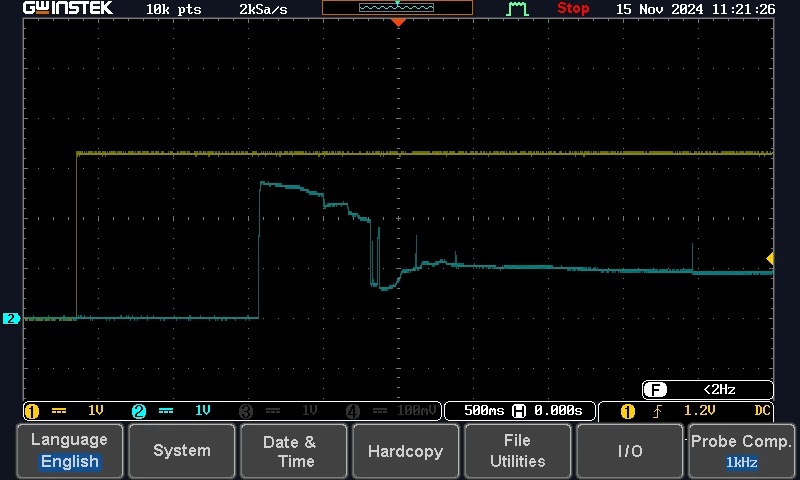

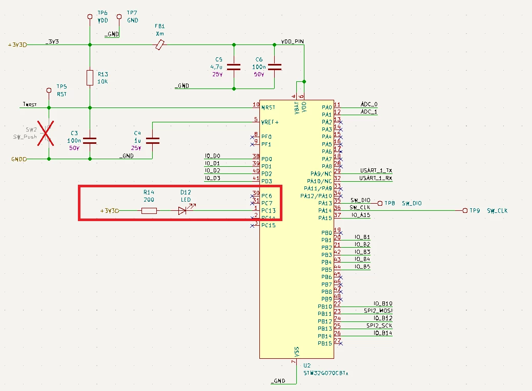

Hi, I'm facing a very strange issue with my G070CBT6-based board...

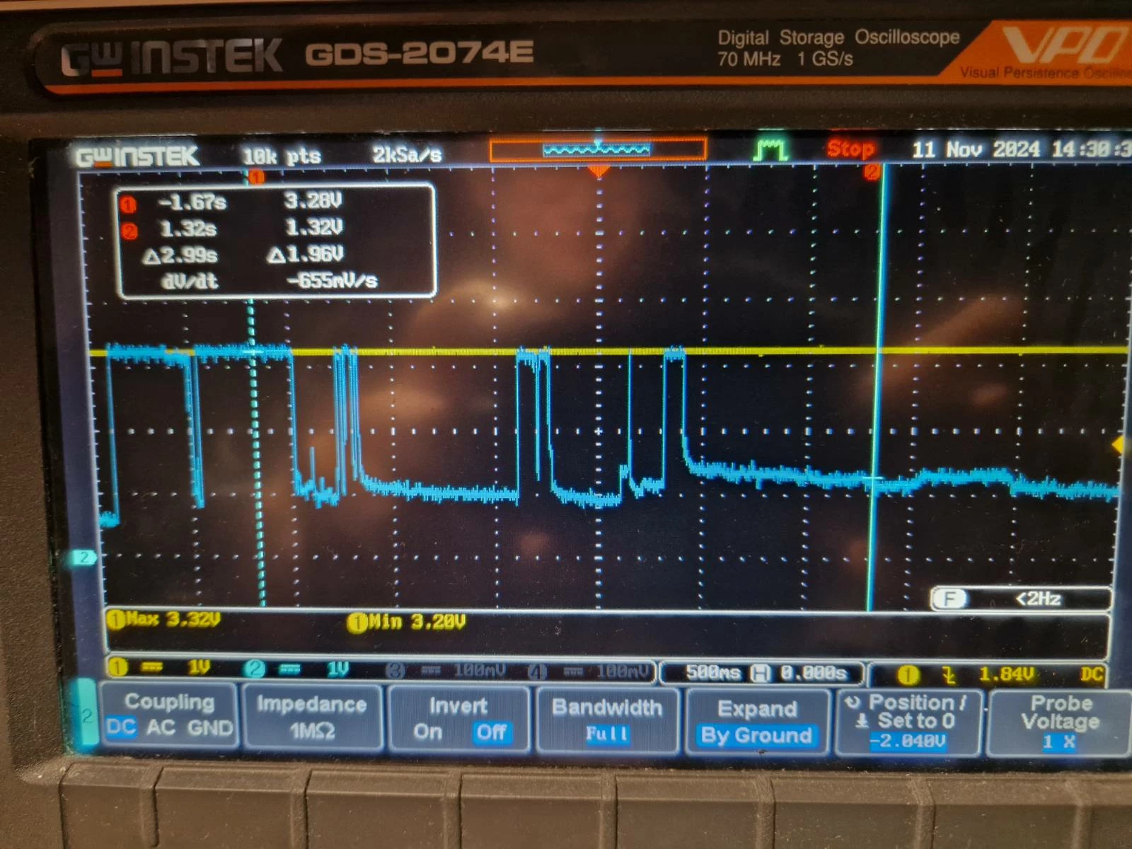

When I start work and power up the board everything works fine for a couple of minutes (let's say 5 minutes ) but later I can observe some disturbances on the reset pin... I connect the oscilloscope and I can see the voltage on the reset pin, after a few minutes of the device operating, starts to fall down slowly and there is some mess on the signal...
Here is an example waveform watched:
Yellow -> 3.3V supply
Blue -> reset line
I've tried 3 different pcs of the MCU on the same board and also try soldering bare minimum setup (LDO, MCU, caps, etc.. ) on a totally fresh PCB, and every time the same behavior...
No matter, if the code flashed, is my application code, led blink demo, or totally erased flash.

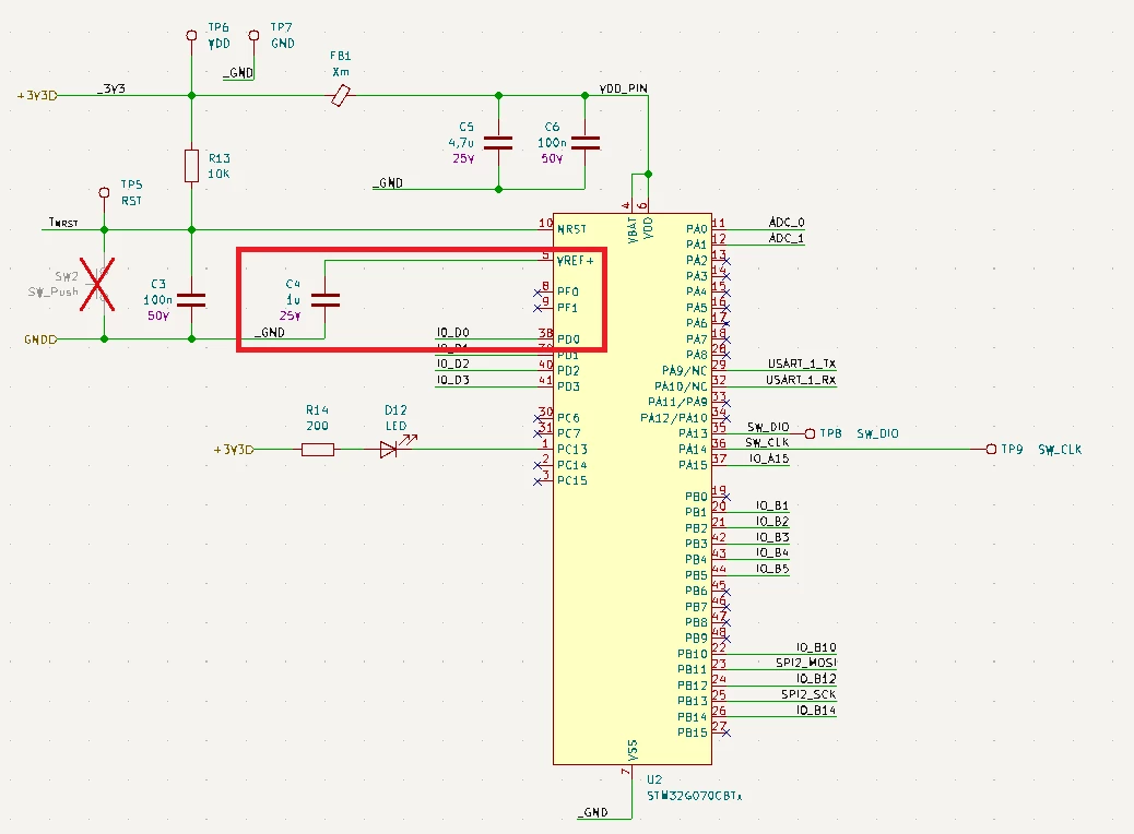

This is the MCU part of the schematic..Screenshot from 2024-11-14 23-04-40.png  I also tried to pull down the SW_CLK ( there is the BOOT0 also on this pin ) but this ain't help...
When the issue occurs, I'm not able to do anything with the MCU. It is "held under reset" from the SWD perspective. If I leave the board unpowered for some time to "cool down" it starts operating again, but again only for a couple of minutes... The MCU is not getting hot or something... supply is very stable 3.3V...
Any ideas what is going on with this? I have never had similar issues and I doubt that I broke the MCU during soldering...

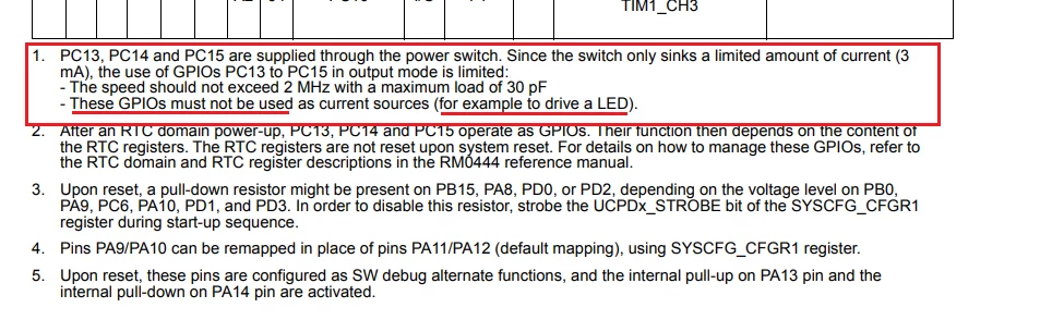

+ the LED on PC13:
From the datasheet:

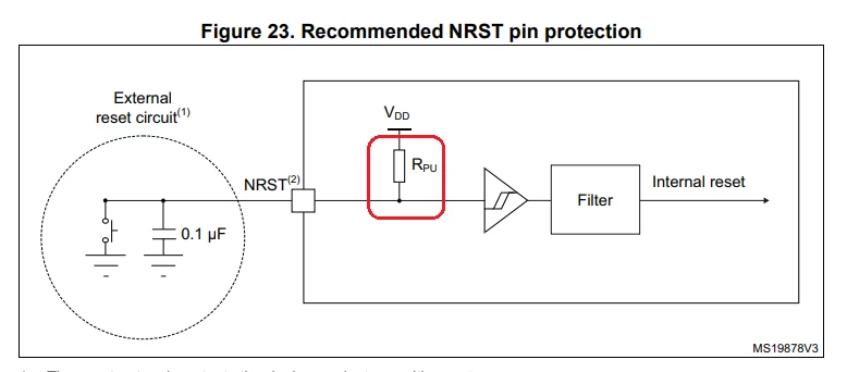

It could be not related to the behavior but please remove that NRST pull-up resistor as there is one internal to the chip:
MKowalskiAuthor
November 15, 2024
I'm aware of that but this is a 40K resistor so I think that adding 10K externally could only improve the immunity here.
Anyway, I removed it as You suggested but the problem still exists.

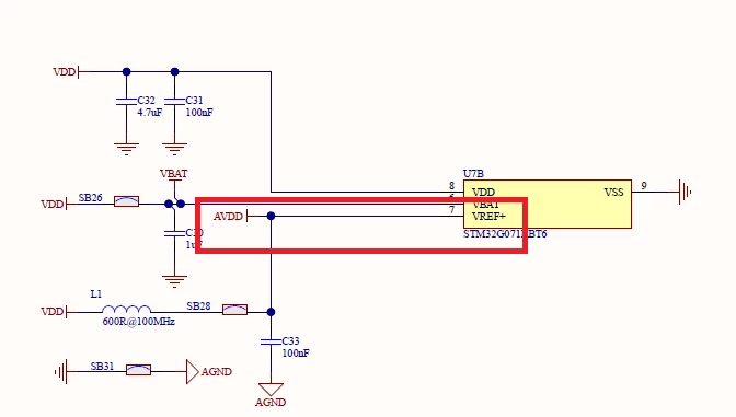

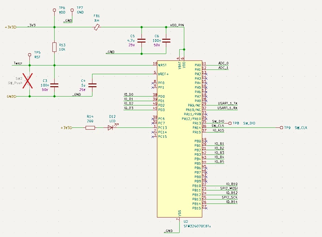

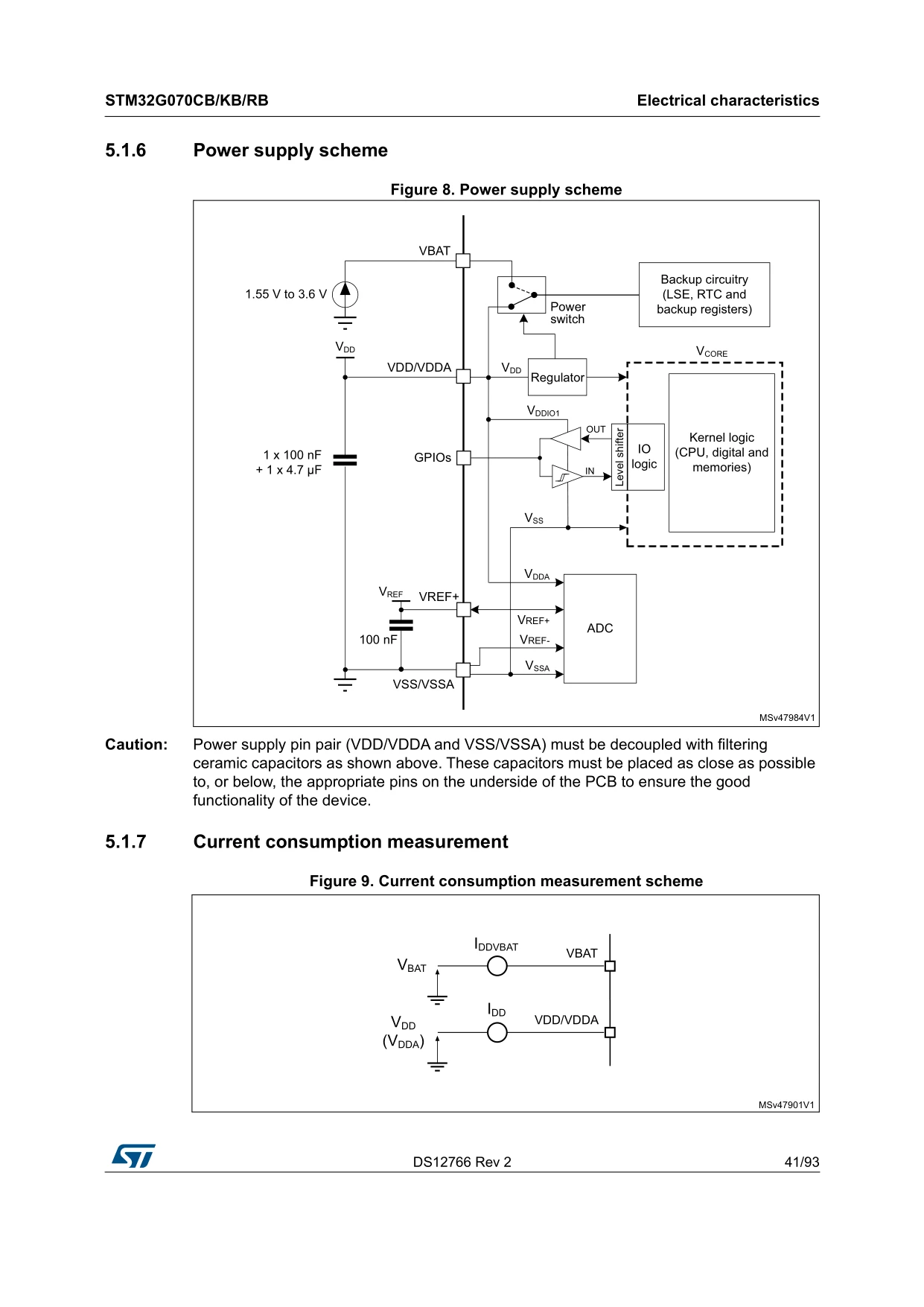

Also there is an issue on VREF+
Vref+ is not connected to an external power source example: VDD!
From NUCLEO schematics:
Please make the nucleo schematics as your reference design.

+ the LED on PC13:
From the datasheet:
MKowalskiAuthor
November 15, 2024
 This is something I missed. I'll check. Thanks for pointing.
waclawek.jan
November 15, 2024
Hi @mƎALLEm ,
On 'G0, VREF+ does not need to be connected to VDD/VDDA if analog functionality is not used.
While the 'G070 officially does not have VREFBUF, those 'G0 which do have it must not connect VREF+ to any external source.
mƎALLEm
November 15, 2024
Indeed. Only G070 doesn't have an internal VREFBUF. So Vref+ needs to be connected to a power source.
MKowalskiAuthor
November 15, 2024
I moved the LED to PB9 and connected VREF+ to VDD, but the problem has not been solved.

The schematics don't show all the connectivity: USART1, IOs, SPI etc .. Is there something connected to the MCU?
MKowalskiAuthor
November 15, 2024
Yes, the pull-up is removed, and there is nothing else connected.

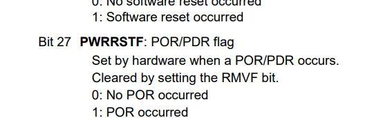

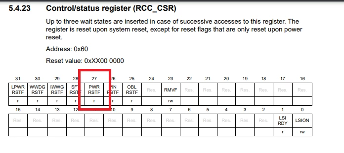

You said: "supply is very stable 3.3V.."
Try to monitor your power supply again and find if there is a glitch (try to use a trigger).
Check if the power is the origin of that reset by checking that bit:
MKowalskiAuthor
November 15, 2024
This is the moment of powering up the board with the reset button pressed and released after about 1s...
As You can see it seems not to be related to the power supply...
mƎALLEm
November 15, 2024
Monitor PWR RST flag..

Also, the circuit connected to PD0/PD2, does it account for the 5k1 pulldown mentioned in footnote 3 to pinout table in datasheet?
MKowalskiAuthor
November 16, 2024
I've assembled one another board and checked each pad of the MCU with a microscope to be 100% sure there are no issues with soldering. I also did not populate the LED so the PC13 does not drain too much current and this particular board is now operating fine for over an hour. So my simple conclusion is that maybe draining too much current from PC13 could break something inside the MCU, causing this issue with previous boards (each of them was first started with the LED on PC13 enabled). Or indeed some design issues ( like too much heat dissipation on GND pin, what I suspect is also possible after reviewing the layout ) make me mess up soldering so many times...
Anyway the board works fine no matter if there is additional pull-up on the reset pin or Vref+ connected to VDD or not. If the issue will not occur again till the end of the day I will consider this topic closed.
