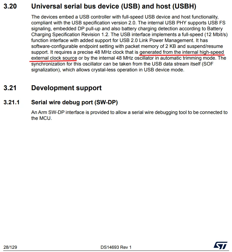

Funny statement in STM32C071 datasheet
Section 3.20: "It requires a precise 48 MHz clock that is generated from the internal high-speed
external clock source"
So we have "internal external" clock source. ;)

@Andrew Neil wrote:
So it does!
https://www.st.com/resource/en/datasheet/stm32c071kb.pdf#page=28
I think there is something missing in the statement. There are two possible clock sources: HSIUSB48 and HSE.
Yes, it does mention the two:
external clock source or by the internal 48 MHz oscillator in automatic trimming mode"
So
  1. "the internal high-speed external clock source"  is (meant to be) HSE;
  2. "the internal 48 MHz oscillator in automatic trimming mode" is HSIUSB.
I guess what they meant to say was something like, "HSE routed internally" ?

Hello @gbm ,
Thank you for your comment, I'm checking internally and getting back to you as soon as I have a feedback.
Ticket number for follow-up: 194454.
Simon.T
Oct 21, 2024 11:52 AM UTC
Hello @gbm ,
Indeed, the word "internal" is a typo. The right sentence would be:  "It requires a precise 48 MHz clock that is coming from a high-speed external clock (from an external source or an oscillator) or by the internal 48 MHz oscillator in automatic trimming mode."
This typo will be fixed for the next document revision. Thanks for spotting this typo, and enjoy the STM32C071 !
Best regards,
Simon

Feb 11, 2025 11:40 AM UTC
The modification proposed by @Simon.T has been implemented and the document will be available soon on the ST website.
