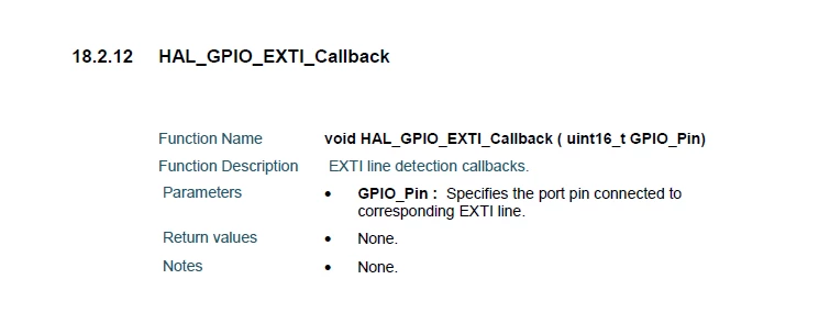

    aaron239955_stm1_st
    Senior
    Jan 4, 2017 5:09 PM UTC
    Posted on January 04, 2017 at 17:09
    HAL provides a callback that you can use:
    This routine is called when the HAL interrupt handler is called (the code you are looking at in the *_it.c file).  If you write your own routine like this:
    void HAL_GPIO_EXTI_Callback(uint16_t GPIO_Pin){
       if(GPIO_Pin == GPIO_PIN_0){
          do stuff;
       else if (GPIO_Pin == GPIO_PIN_1){
          do other stuff;
    it will do what you want.  This is in the GPIO section of the HAL reference manual.  I took the one from the F0 family but they are pretty much all the same.
    You do not need to touch the interrupt code in the *_it.c file.  It will do what you want.
