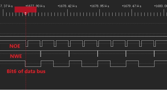

Hi Team,
STM32F407 running on STM32F4xx_DSP_StdPeriph_Lib_V1.8.0 with the following init configuration,
void USBFIFO_FSMCConfig(void)
FSMC_NORSRAMInitTypeDef FSMC_NORSRAMInitStructure;
FSMC_NORSRAMTimingInitTypeDef p;
p.FSMC_AddressSetupTime = 0X00;//0
 p.FSMC_AddressHoldTime = 0X00;//0
 p.FSMC_DataSetupTime =0X5;//1
 p.FSMC_BusTurnAroundDuration = 0X01;
 p.FSMC_CLKDivision = 0X00;
 p.FSMC_DataLatency = 0X00;//0
 p.FSMC_AccessMode = FSMC_AccessMode_A;
//NE2
FSMC_NORSRAMInitStructure.FSMC_Bank = FSMC_Bank1_NORSRAM2;
FSMC_NORSRAMInitStructure.FSMC_DataAddressMux = FSMC_DataAddressMux_Disable;
FSMC_NORSRAMInitStructure.FSMC_MemoryType =FSMC_MemoryType_SRAM ;//;  FSMC_MemoryType_NOR
FSMC_NORSRAMInitStructure.FSMC_MemoryDataWidth = FSMC_MemoryDataWidth_8b;
FSMC_NORSRAMInitStructure.FSMC_BurstAccessMode = FSMC_BurstAccessMode_Disable;
FSMC_NORSRAMInitStructure.FSMC_WaitSignalPolarity = FSMC_WaitSignalPolarity_Low;
FSMC_NORSRAMInitStructure.FSMC_WrapMode = FSMC_WrapMode_Disable;
FSMC_NORSRAMInitStructure.FSMC_WaitSignalActive = FSMC_WaitSignalActive_BeforeWaitState;
FSMC_NORSRAMInitStructure.FSMC_WriteOperation = FSMC_WriteOperation_Enable;
FSMC_NORSRAMInitStructure.FSMC_WaitSignal = FSMC_WaitSignal_Disable;
FSMC_NORSRAMInitStructure.FSMC_ExtendedMode = FSMC_ExtendedMode_Disable;
FSMC_NORSRAMInitStructure.FSMC_WriteBurst = FSMC_WriteBurst_Disable;
FSMC_NORSRAMInitStructure.FSMC_ReadWriteTimingStruct = &p;
FSMC_NORSRAMInitStructure.FSMC_WriteTimingStruct = &p;
FSMC_NORSRAMInit(&FSMC_NORSRAMInitStructure);
// enalbe NE2
FSMC_NORSRAMCmd(FSMC_Bank1_NORSRAM2, ENABLE);
and the following read command,
FT_Data_In[Counter_Fifo_Read] = FIFO_FSMC->Read; // FIFO_FSMC->Read = 0x64000000(address)
got the following wave of NOE, NWE and bit 6 of 8bit width data bus.
0693W0000059qVOQAY.png​confirmed that bit6 output is good, but confused why NWE goes low when excute Read opeation? could you give some help?

waclawek.jan
October 30, 2020
Floating NWE, i.e. incorrectly initialized in GPIO, or write not enabled in FSMC?
