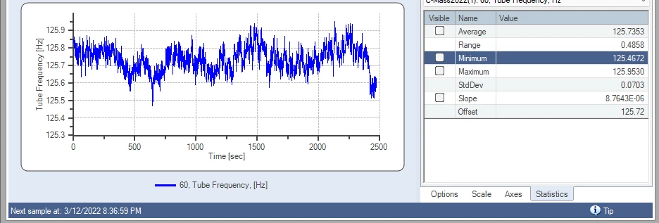

I created a frequency meter app for the NUCLEO board, but the quality of the frequency measurement a sinusoidal voltage is very poor. I have a generated 720mV RMS, 126.7Hz signal between 0 and +2.5V (max) biased to +1.25V. On scope, the frequency meter connected to the output of the COMP1 shows 126.700x, the 4th digit is 1 or 0. The NUCLEO board measures almost 1Hz less than the frequency meter on scope (I checked it with a real frequency meter and the scope value is right).
My other problem is that the minimum value of the frequency = 125.451, the maximum value = 125.9264Hz, the average = 125.7246 and the standard deviation = 0.0775Hz. I could not measure the frequency as good as a simple scope.

  1. Why do I have so poor quality of the measurement? (See attached log picture)

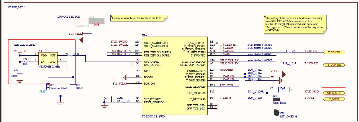

What's the primary clock source?
If it's STLink3's 8MHz output, that is not derived from crystal.

Hi waclawek.jan,
Yes, STLINV3 8MHz is the primary clock. The are no other (real) chances. STM does not assemble the 25MHz crystal (X3) and two caps. Without soldering a 25MHz crystal + 2 caps manually into the board, the STLINV3 8MHz is the only chance for the clock source. By the way, the STLINKV3 works from X1 25MHz crystal. Why do you think the 8MHz is not crystal clock? I guess STLINKV3 has a PLL which generates the 8MHz (DIV=25, MUL=8) but I do not know that chip.

waclawek.jan
March 17, 2022
I've told you already that STLink3's 8MHz output is not derived from crystal (which means it's derived from its HSI). And your symptoms confirm it. What's the point of your repeated posts, then?
And no, 'F723 used as STLink3 cannot generate 8MHz from 25MHz.
In CubeProgrammer you probably can switch STLink3's output to a different frequency, derived from the 25MHz crystal. I don't use CubeProgrammer nor STLink3. There are several related threads on this forum, search.

Peter BENSCH
March 18, 2022
Well, as @Community member​ wrote, the clock for the target STM32H723ZGT6 is fed from the MCO of the ST-LINK-V3E. The ST-LINK-V3E itself is driven by a STM32F723IEK6, in whose clock scheme the MCO outputs can only be fed from four sources and a divider 1:1...1:5 before the output: LSE, HSE, HSI and PLLCLK. Unfortunately, the (non-changeable) MCO frequency chosen for the ST-LINK-V3E is not the HSE, but 8MHz, which cannot be derived from the required PLLCLK, but only from the HSI.
So if you need a crystal stabilised clock on the STM32H723ZGT6, you must indeed could:
  • either assemble X3 and the load capacitors or
  • set the ST-LINK-V3E to HSE/3, i.e. 8.333MHz

waclawek.jan
March 18, 2022
Hi @Peter BENSCH​ ,
Can't the STLinkV3 switched to output HSE/3=8.33MHz as outlined in https://community.st.com/s/question/0D53W00000j62rkSAA/how-to-change-the-stlinkv3e-mco-hse-frequency ?
I don't have STLinkV3 to try but at least Clive appears to confirm that this is indeed possible.
Can you please try/confirm?

Peter BENSCH
Peter BENSCHBest answer
March 18, 2022
Oops, sorry, Jan is right.
Yes, with ST-LINK-V3E you can set the MCO output to one of three possibilities:
  • Default (HSI/2) = 8MHz
  • HSE/3 = 25/3 MHz
  • Off
I have already crossed out my statement above.
I apologise for forgetting this for a moment.
