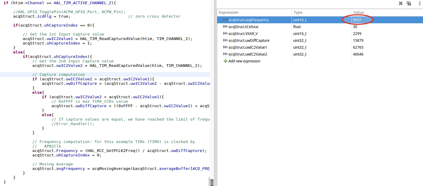

I'm measuring a 40-60Hz frequency range from an input capture timer (STM32L475RCTX TIM4). The result is an expected calculation from 4000 to 6000 (40.00Hz-60.00Hz) using this initialization code:

The frequency computation is performed in HAL_TIM_IC_CaptureCallback routine and here's the result form an input frequency of 50.00Hz:

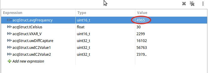

The result is 5037 that means 50.37Hz and the 0.37Hz does not a problem so far. The problem is when I pause the execution, restart and resume it. Then the result sometimes falls in 5037 (the same result than before) but sometimes is 4965 as shown:
0693W00000D0bWpQAJ.pngThe result changes when I do a pause, restart (reset) and resume the execution from the IDE. How can I manage to always get the same frequency result after successive restart cycles?

TDKBest answer
Jul 26, 2021 2:36 PM UTC
You need to use the same edge for the frequency calculation unless you have a guaranteed 50% duty cycle. Probably you don't have this and the difference is just due to capturing rising then falling vs. capturing falling then rising. Every reset would randomly choose between the two.
