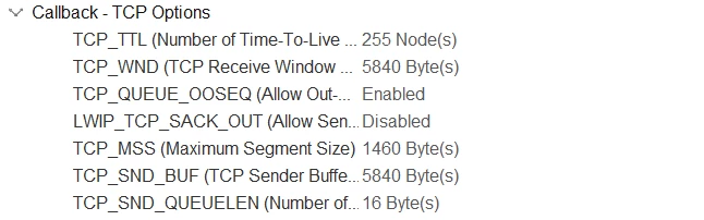

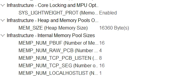

Im currently trying to set up a project where Freertos controls a webserver via lwip.
I tried following these tutorials/guides and managed to be able to ping the board but not get it to host the webserver.
https://github.com/MayaPosch/FreeRTOS_HTTP_server/tree/master
https://community.st.com/t5/stm32-mcus/how-to-create-project-for-stm32h7-with-ethernet-and-lwip-stack/ta-p/49308/show-comments/true
Both of these are not for the STM32F429ZITx board So I copied what I thought I needed.
Right now I have it set up like this:
for the code:
The default task calls http_server_netconn_init that cretes a thread. Then this thread is the same as in this tutorial:
I also coppied the exact same files over for the fsdata.

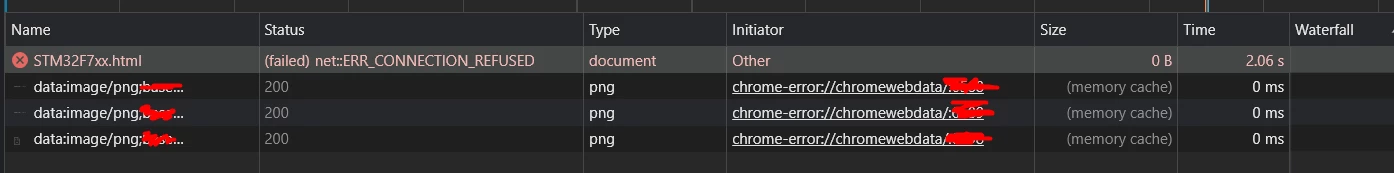

Im connected via a static ip and when I type the IP in the browser or any link to a page it refuses the connection. I also used Advanced IP scanner to check If it was hosting something, but there was nothing.

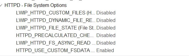

So I got it to work, here are my findings for anyone who has the same problem.
- You don't need to activate HTTPD in your ioc file for this to work.
- On this github page: https://github.com/MayaPosch/FreeRTOS_HTTP_server/tree/master
There are two ways: just a static page with fsdate or dynamicly generate the page.
Staticly I didn't get it to work but its probably possible, dynamicly however works fine.
- It possible that you can't transfer the entire website in one netconn write, I have done it with multiple netconn writes.
There are probably better ways of doing it. But this works.
What do you mean, "refuses" ?
Do you get an HTTP 4xx failure status?
https://en.wikipedia.org/wiki/List_of_HTTP_status_codes#4xx_client_errors
WilliamVRAuthor
March 19, 2024
Well Chrome is being a bit vague, I get this:
so there is probably an error somewhere with the TCP transmission.
Andrew Neil
March 19, 2024
I think ERR_CONNECTION_REFUSED is probably at the TCP layer - so it's not even getting to your webserver?
