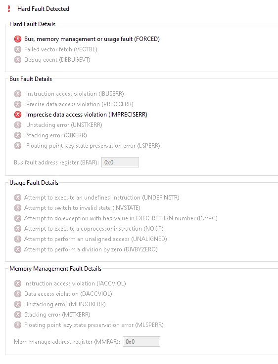

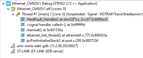

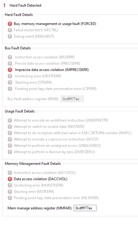

This seems to run fine on my board, until I changed lines 17 and 18 to some string longer than "echo". For example, the following code will cause the MCU to hard fault right away on startup (even before any client tries to connect):
char echo_msg[8] = "echo1234";
u16_t echo_len = 8;

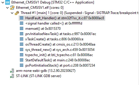

The program seems to crash at some memset() in startup. Here are two examples of the crashes:

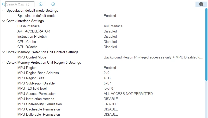

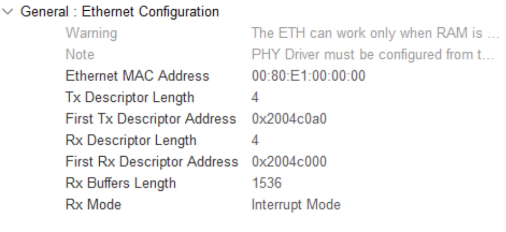

I tried flashing this exact same code onto a STM32F746G-DISCO, and it works perfectly, regardless of the string contained in echo_msg. The MPU configuration is the same for both:

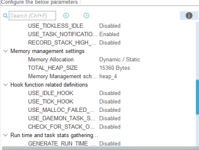

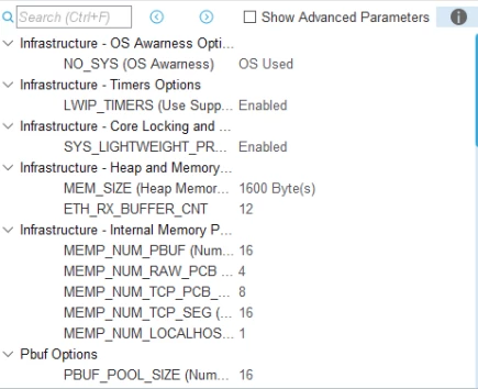

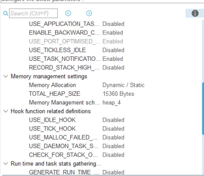

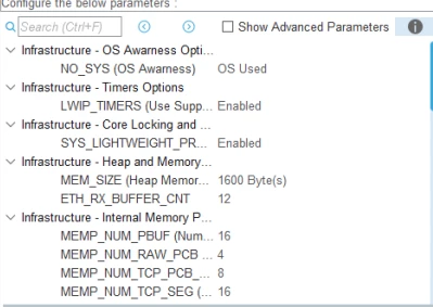

All the settings for freeRTOS and LwIP are set to default, except for the defaultTask stack size, which I set to 512 words.

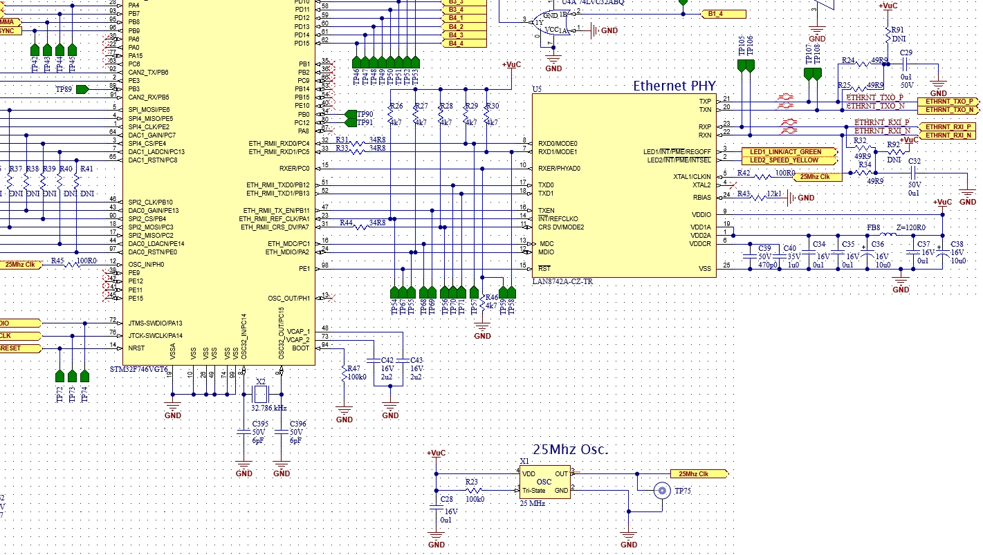

Here is the partial board schematic:

Took us some time to solve the issue, but it turned out that our VCAP1 and VCAP2 capacitors for the regulator stabilization were installed incorrectly at a value of 2.2 nF. When we replaced the capacitors with the proper value of 2.2 uF, all our issues were resolved.

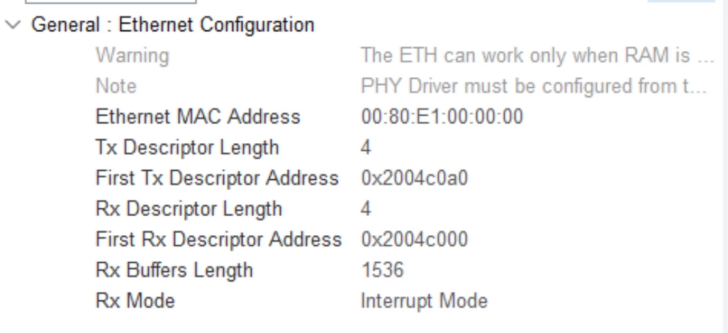

also, could you check the placement of the ethernet descriptors and Lwip heap and the way you are allocating stack for your FreeRtos tasks?

Thank you for your response. Yes, when I flash the same code onto the STM32F746G-DISCO board, I don't get any hard faults. I have checked the placement of the ethernet descriptors, the LwIP heap, and the freeRTOS task stacks. They are all the exact same for both boards. I've attached the associated configurations below.

make sure also that the .ld file places the descriptors in the same region as the Discovery board and that the memory region definitions are the same.
