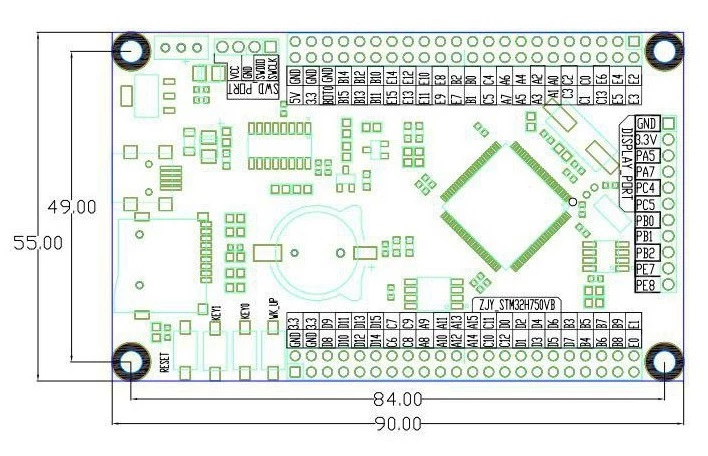

0690X00000AsLsgQAF.jpgOk, so have the H750 version of this board. The manufacturer is ZJY TECH
UART/VCP is USART1 PA9/PA10
SDMMC is PD2, PC8..12, no card detect
LEDs are PB10, PB11
BUTTONs are WKUP PA0 (pullled low, press for high), KEY0 PA1 (pulled high, press for low), KEY1 PA2 (pulled high, press for low)
The above all work well.
Haven't been able to get schematic from vendor. QSPI/SPI doesn't seem to be working on external FLASH, not determined connectivity there.

I think the H750 board is probably a good purchase, though I'd still go for the Nucleo board myself.
It's a shame about the flash (try checking the connections with a multimeter to see where they go).
-Can you test if the RTC is accurate ?
(from the looks of it, they took care making the PCB layout well, but sadly one can not assume that the people assembling the board didn't use 'generic crystals' they had on stock or matching capacitors).
