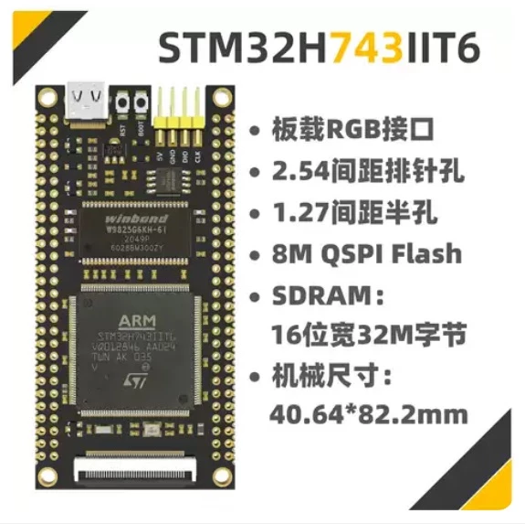

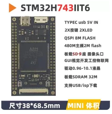

These Kitchen-Sink board are not really suitable for prototyping additional functionality.
You can use SDRAM on a smaller subset of FMC pins than are needed for external SRAM/NOR/NAND. You can remove parts and recover pins that aren't used for any other purpose. Although an expensive board to hack up, and awkward high density connectors. Perhaps cheaper ArtPi, WeAct and FANKE boards that might be better proxies.
On your own solution you could use DSI, QSPI and SDRAM with fewer pins.

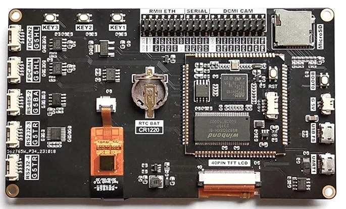

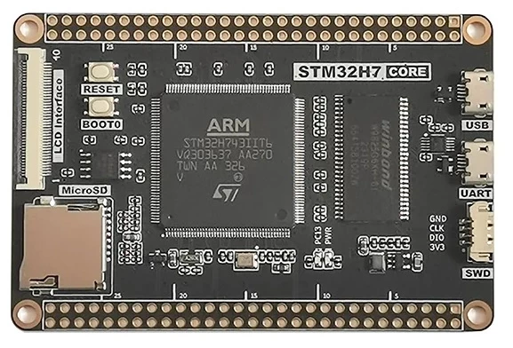

Tesla DeLorean
Guru
May 12, 2024
The pin count and complexity of the Display & SDRAM tend to have me discount the NUCLEO's as proxy
WaveShare ? They have board and panels
Not specific recommendations, but starting points to their offerings
https://www.waveshare.com/product/mcu-tools/openh743i-c-package-b.htm
https://www.waveshare.com/product/mcu-tools/coreh743i.htm
