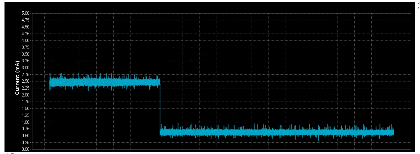

Here's an example of my main() using on a NUCLEO-L452RE (nothing connected) just pins configured. I'm using the button on the Nucleo configured as an interrupt to be able to wake the system for my example. Also is the current measurement which averages ~625uA in stop 2.
int main(void)
 /* USER CODE BEGIN 1 */
 /* USER CODE END 1 */
 HAL_Init();
 /* USER CODE BEGIN Init */
 /* USER CODE END Init */
 SystemClock_Config();
 /* USER CODE BEGIN SysInit */
 /* USER CODE END SysInit */
 MX_GPIO_Init();
 MX_USART2_UART_Init();
 MX_I2C1_Init();
 MX_USART1_UART_Init();
 MX_USART3_UART_Init();
 MX_QUADSPI_Init();
 /* USER CODE BEGIN 2 */
 /* USER CODE END 2 */
 /* Infinite loop */
 /* USER CODE BEGIN WHILE */
 while (1)
 /* USER CODE END WHILE */
 /* USER CODE BEGIN 3 */
	 //normal run mode
	 HAL_GPIO_WritePin(GPIOA, LD4_Pin, GPIO_PIN_RESET);
	 HAL_Delay(5000);
	 //stop mode 2
	 HAL_PWREx_EnterSTOP2Mode(PWR_STOPENTRY_WFI);
	 //flash LED
	 HAL_GPIO_WritePin(GPIOA, LD4_Pin, GPIO_PIN_SET);
	 HAL_Delay(100);
 /* USER CODE END 3 */

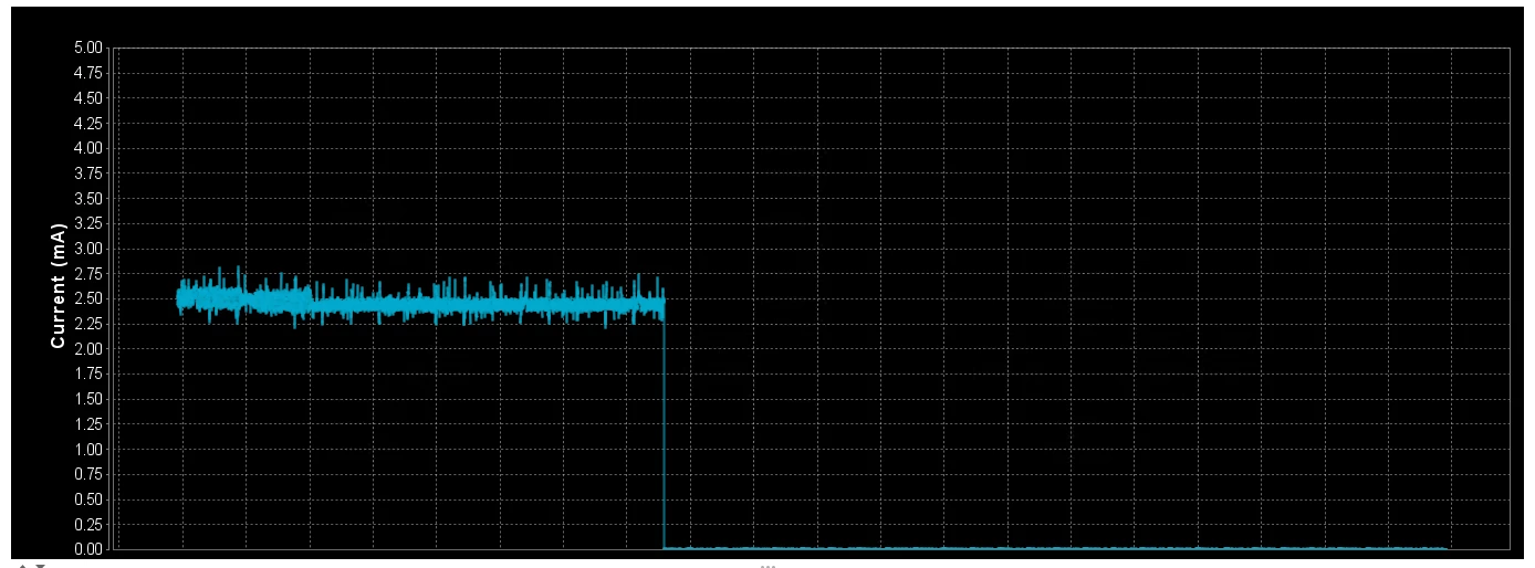

Now if I modify the code to disable the peripherals before stop mode 2, the current is much better at ~2.6uA. I re-enable them after wakeup.

	 HAL_UART_DeInit(&huart1);
	 HAL_UART_DeInit(&huart2);
	 HAL_UART_DeInit(&huart3);
	 HAL_I2C_DeInit(&hi2c1);
	 HAL_QSPI_DeInit(&hqspi);
	 MX_I2C1_Init();
	 MX_QUADSPI_Init();
	 //flash LED
	 HAL_Delay(100);
