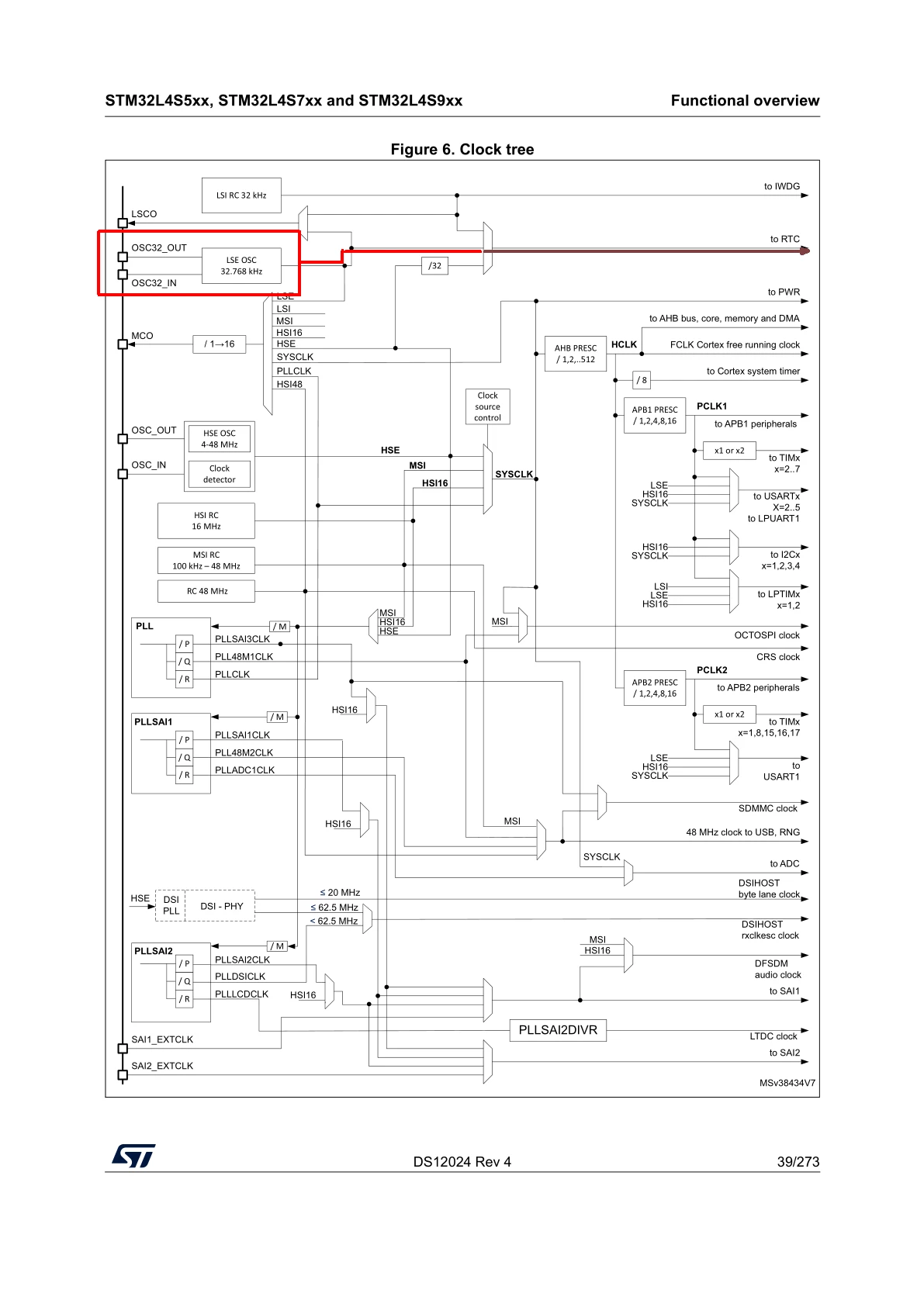

> I'm not sure what you mean by LSE
This:
i.e. externally connected 32.768kHz crystal, or externally connected 32.768kHz crystal oscillator.

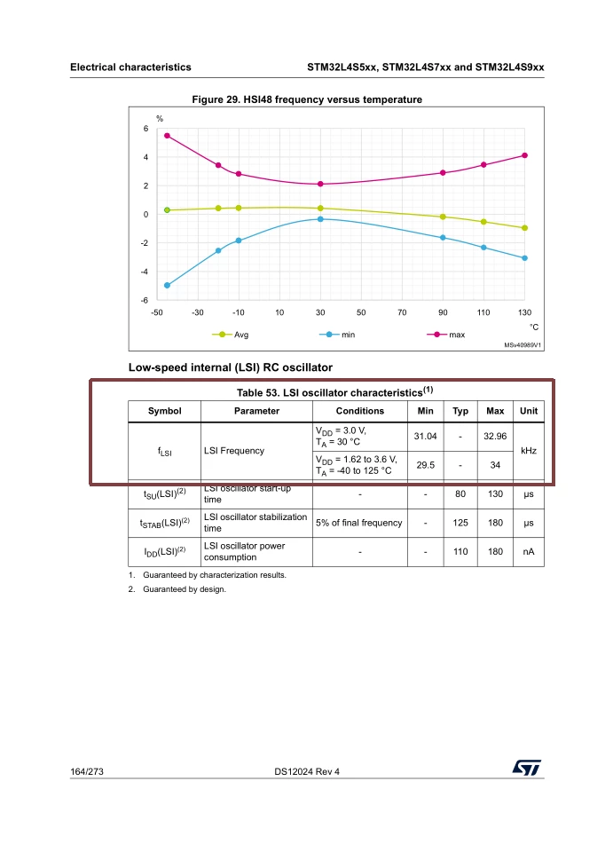

If you run RTC from the LSI i.e. the internal low-speed RC oscillator, note, that it's principially imprecise and not stable for precise timekeeping purposes.

It's highly unusual to have 400ppm deviation with the standard 32.768kHz crystal, so that indicates that you either don't run RTC off that crystal (and by mistake run it out off LSI), or there is some serious hardware problem with the crystal oscillator itself.
Read out the RCC_BDCR register content and check if RTCSEL field is set to 0b01 for LSE. Check if LSECSSON+LSECSSD are not set.
Read out RTC registers content and check if prescaler values in RTC_PRER match the expected total division value (the default value of PREDIV_A=0x7F and PREDIV_S=0xFF are OK for 32768).
Read AN2867 for hints about hardware. Note, that you cannot measure LSE oscillations using common oscilloscope probe, as it's an extremely low power circuit; you'd need to set output of LSE onto LSCO pin and measure there.
For reference, you could/should try to run the RTC on a "known good" hardware such as the Nucleo or Disco board.
