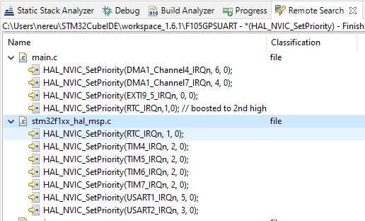

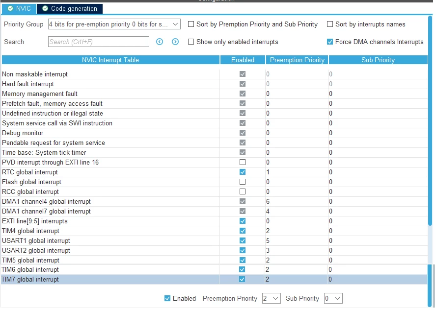

For interrupt priorities set using the STM32IDE CubeMX, where are the auto-code generated HAL_NVIC_SetPriority() calls located?
I could locate the HAL_NVIC_SetPriority() calls for DMA and EXT1 Interrupts in main.c as shown below.
I could not find the  HAL_NVIC_SetPriority() calls for RTC, USART & Timers - TIM4, TIM5, TIM6, TIM7. Where is the interrupt priority for these peripherals set in the code by CubeMX?
The CubeMX configuration is as follows :
0693W00000Kb9w3QAB.pngHAL_NVIC_SetPriority() calls found in main.c

You can use Search -> File... to find all instances of HAL_NVIC_SetPriority to see if/where they exist.
It's possible they aren't set up at all if the peripheral isn't enabled.

Thanks, the HAL_NVIC_SetPriority() calls are added to the stm32f1xx_hal_msp.c file in the HAL_<Peripheral>_MspInit() functions
