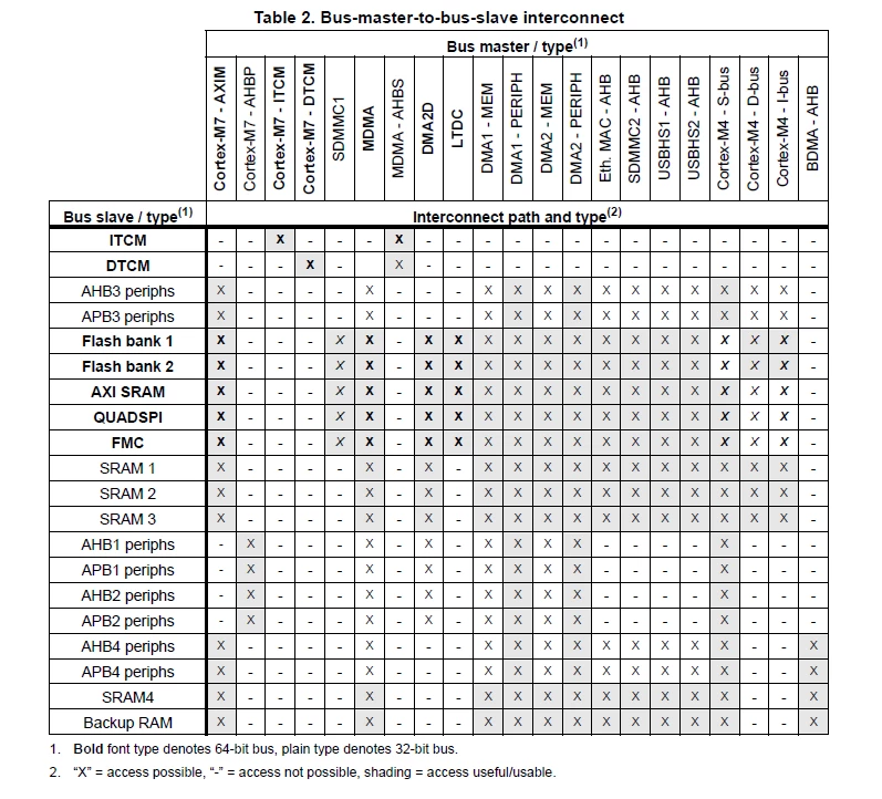

I want share FMC(interface SDRAM) core between CM4 and CM7 core on STM32H7.
I config by cubeMx, CM7 can access ok but CM4 can not access.
How to access FMC core by CM4 and CM7?
Thanks,

What kind of issue do you observed? What is the power state of D1 domain / CM7 when you try to access the SDRAM?

Hi, I use STM32H745XIH6
  • In cubeMx config, I check 2 cpus can access this SDRAM, the CM7 init FMC
    • CM7 access the SDRAM ok, but can not access by CM4
  • when check 2 cpu can access this SDRAM, the CM4 init FMC
    • 2 cpu can not access SDRAM
I check datasheet of MCU, the FMC 2 cpu can access.

in case 2 : "when check 2 cpu can access this SDRAM, the CM4 init FMC"
Can CPU1 access the SDRAM? (just to confirm that it was correctly initialized)
