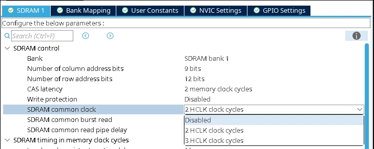

STM32CubeIDE version 1.18.1 has the following options for SDRAM clock:
The selected board is the STM32H743IITx.

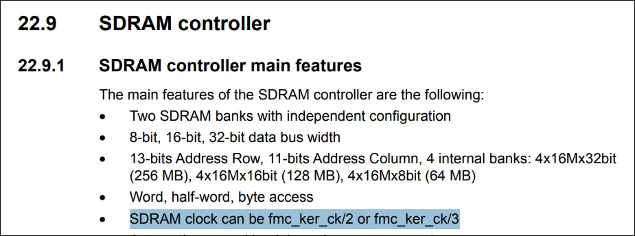

RM0433 Rev 8 states that:

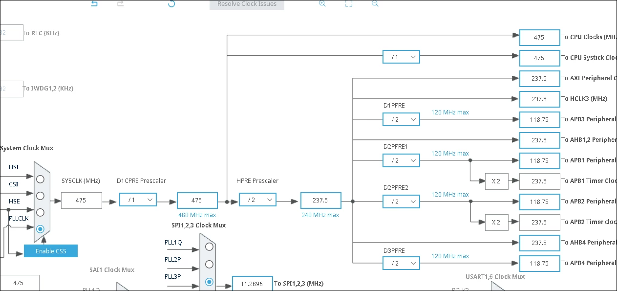

I'm not sure HCLK and fmc_ker_ck are the same thing.

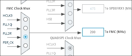

If I have my FMC clock set up as:
And select HCLK/2, I'll have 100MHz for the SDRAM? Or is HCKL system clock?

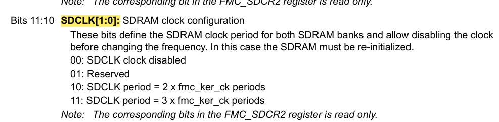

Short answer: yes.

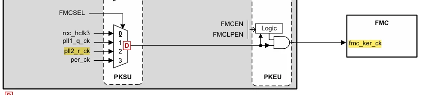

HCLK means fmc_ker_ck here.
If you go through HAL to see what the setting affects, you see it affects this field:
Do a search for fmc_ker_ck and you see where that's from. For you, it's PLL2R.
