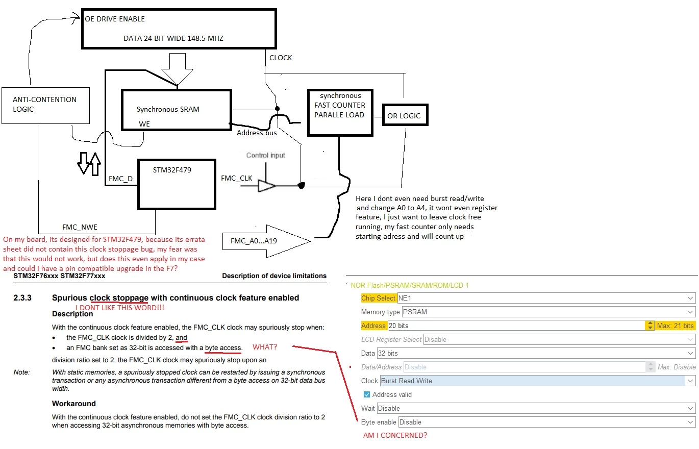

Am I concerned by this errata bug.?
I am always in 32 bit data mode, this is my setup.
Can I use my synchronous clock pin as a "freewheel and forget" scenario and let data "free flow".
